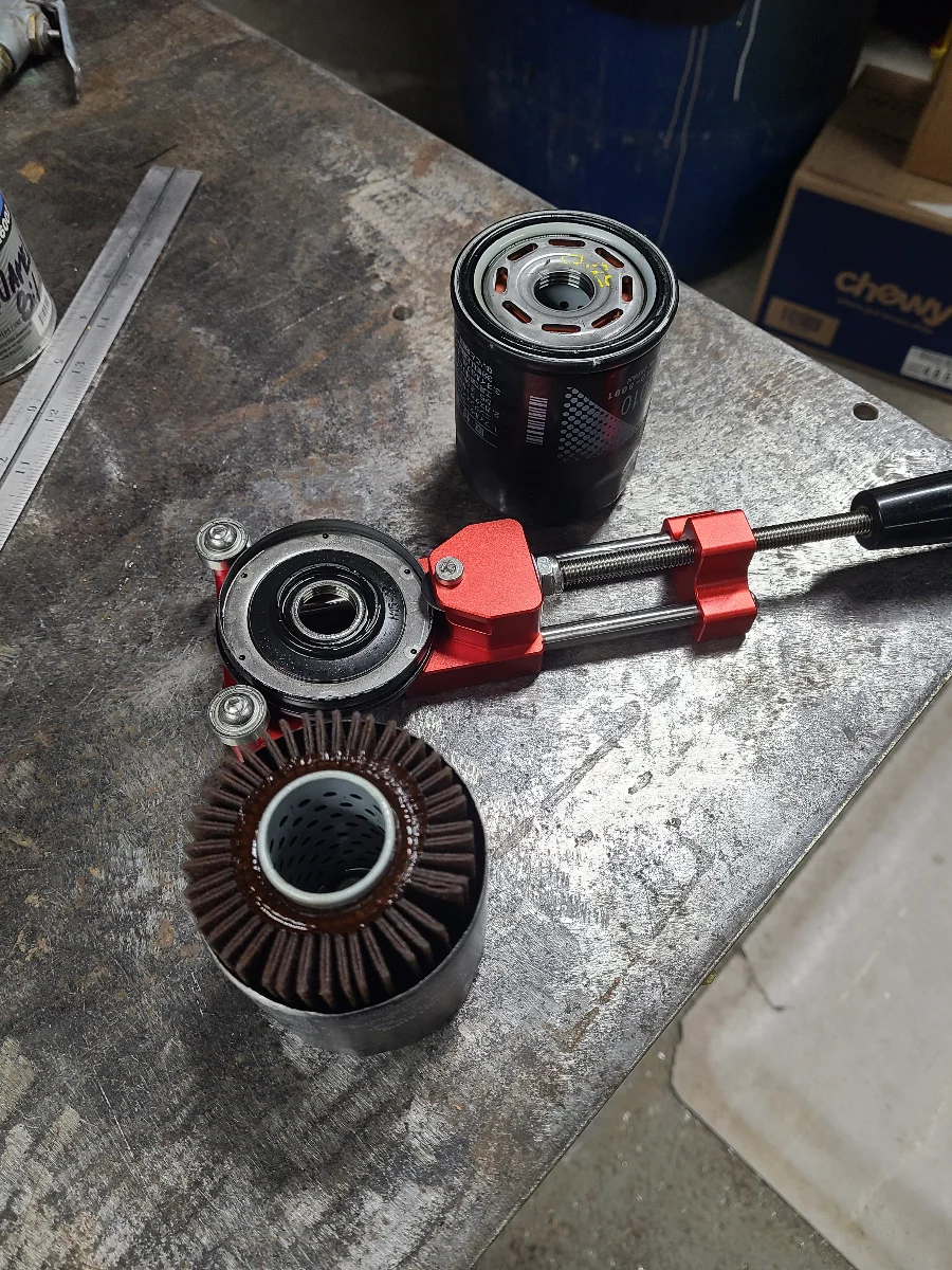

I got my oil filter cutter late yesterday (I am very pleased with it and highly recommend it if you plan to buy one) and opened up the two filters I have changed so far since I bought it. The first one, changed at 764 mi showed a fair amount of light shimmer similar to the pearl found in a fine to medium metallic paint. No larger specks were noticed. The second one, changed at 5690 did not show any fine shimmer that I could detect. I'm happy with that!

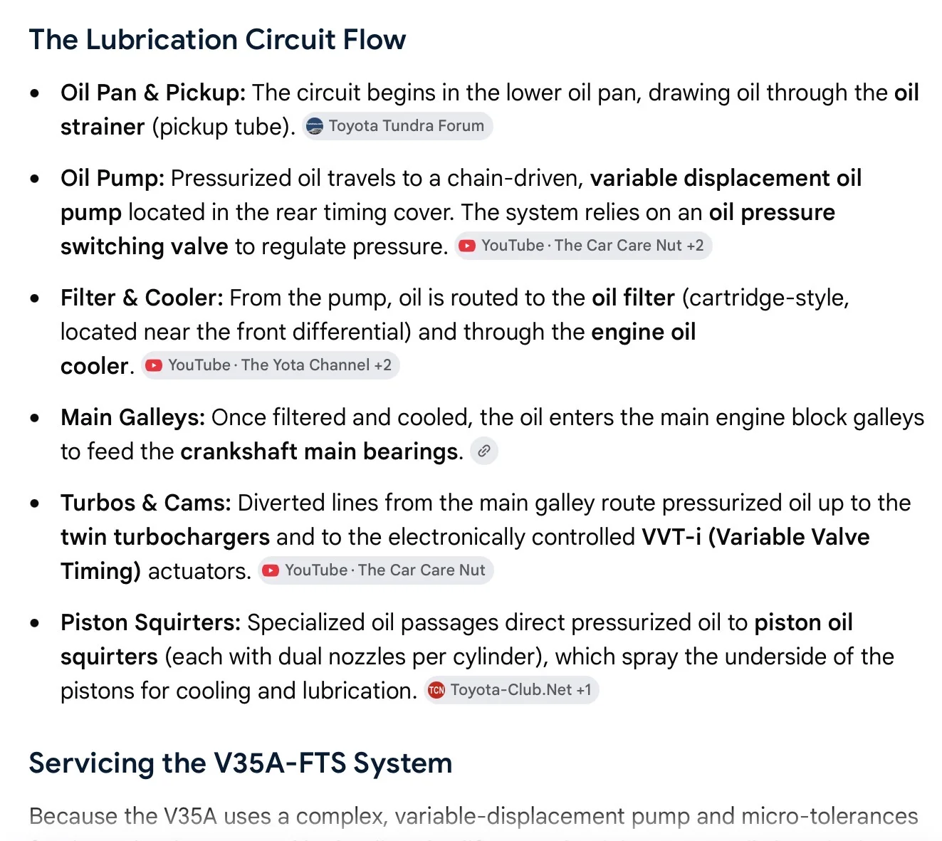

Waiting to 10K for 1st oil/filter change because it’s free is ridiculous. I think changing oil & filter multiple times in the first 10k miles is a significant preventative measure if you’re worried about swarf. Being blunt, it’s the only thing you as an owner could possibly do to delay or mitigate the issue. All first oil changes are going to catch debris from engine components breaking in & manuf. debris. The good news is the filter system is normally immediately after the oil pump in most engines - meaning oil is filtered before being pressurized & circulated. I haven’t found a diagram of the V35A oil circuit sequence to completely confirm the filter sequence location. Oil is doing 2 main things - lubricating parts & helping pull heat away from critical areas. Maybe we should add a 3rd use is that it can help clean out impurities in the oil circuit. In the engines I’ve been around the conventional oil circuit is something like -

When you shut down an engine much of the oil eventually drains to the sump/pan, but there is still oil left in your engine. It’s in galleys, tensioners, lifters, etc. Drain your V35A & let it sit for 2 hours & it will be hard pressed to get 7.7 qts back in without overfilling. I barely get 7 qts back in. Use the proper spec oil (not just the weight) so that the designed oil film remains almost everywhere - especially on flat bearings, & critically for turbos. Pull off the highway to refuel, & when you shut down the engine your turbo impellers are still spinning @ crazy rpms on its bearings. Car makers use to give strong warnings w/ turbo engine owners requiring a 2 min idle to prevent turbo bearing damage, but today’s turbo design & synthetic oil make prevent problems. That same oil film allows us to cold start without catastrophic effects giving protection as oil pressure builds within a second or 2.
