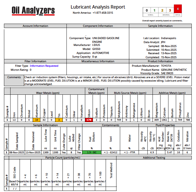

Sharing UOA, factory fill, '25 P+, around 1300 miles. Nothing surprising, seems norm for break-in.

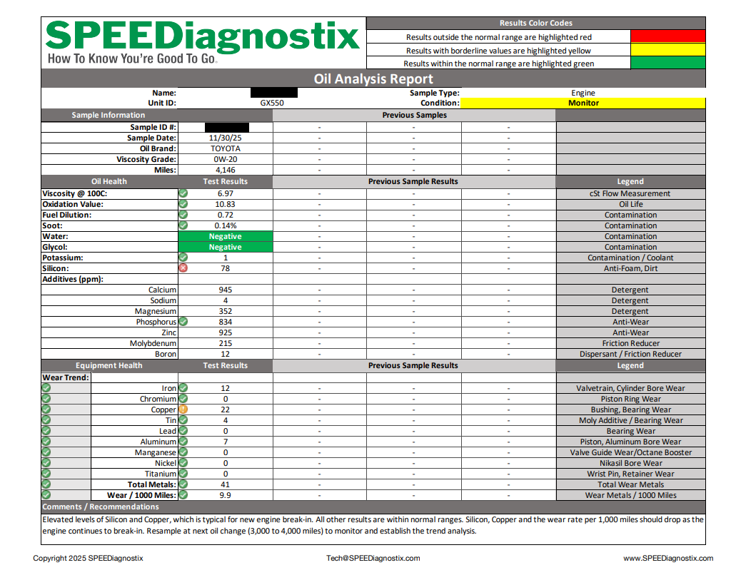

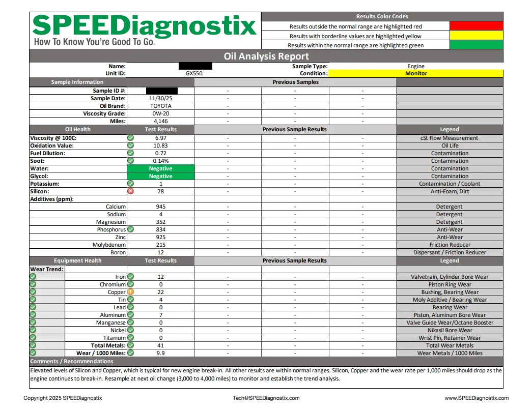

Here's my UOA for my * second * oil change. I did one previous oil change at ~800 miles which I did not have analyzed. Glad to see my elevated silicon and copper levels are not wildly outside the range of normal break in for our engines.
Interestingly, Toyota might have reformulated their 0w20 compared to this VOA from 2021: https://bobistheoilguy.com/forums/threads/toyota-0w-20-sp-voa.341709/
I didn't get the fresh oil analyzed, but my UOA shows meaningfully more phosphorus and zinc than the VOA from that link, which I believe can't happen in normal oil service. Could also be different oil analysis companies using different tests creating this variation.

Rapal11: Did you see on the analysis report it says you have 0w-16? Did you mean to put that in or I may have missed something
