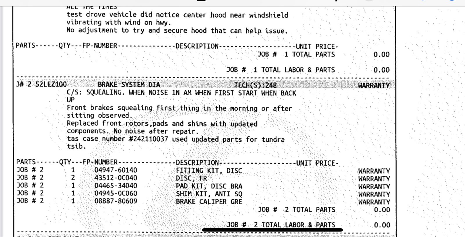

Picked up my OT from service Saturday am…no vibration or brake issues since. Will be on the interstate for 6 hours tomorrow..hopefully optimistic

View attachment 2737Picked up my OT from service Saturday am…no vibration or brake issues since. Will be on the interstate for 6 hours tomorrow..hopefully optimistic
@sroberts This is great news! Hopefully, these symptoms won't come back. Did the ticket have any reference to the ride vibration? Did the brakes have any warped-like symptoms before replacement?

I believe He mentioned that his service people were waiting for replacement break parts to be approved and sent from overseas. Not sure how the breaks would affect the ride, maybe they were somehow rubbing or grabbing while driving without being activated? They had mine in the port on hold for 6 days then released it. Not sure why the held it or what they did, but hopefully I won’t have any issues when it arrives.
We heard back from the service manager today. There is anther OT with the same issues we’ve experienced. Forgive me for not knowing the proper terminology. There are 4 parts that work with the rotors and brakes/independent suspension that are faulty. They use the same 4 parts in the other 550’s, but the OT is the only model affected. Engineering has manufactured these 4 pieces in Japan, and we’re hoping to have them legally approved and shipped by today. They are saying now it will be next week. The fix will be replacing the rotors, brakes and the newly manufactured 4 parts.
Just drove from Alabama to New Orleans..terrible roads, and rode like a dream. No noticeable vibration or hood movement. To those inquiring, this is my previous post. The service manager said the parts replaced would fix not only the brakes squealing, but also the vibration issues and hood flutter.

Brakes wouldn't cause vibration consistently unless a piston was stuck. Also would only cause vibration under application if pad material had built up unevenly on the rotors, which you'd feel as a shimmy in the steering wheel under braking.
Would love to see what those other 4 parts were. A caliper is simply bolted onto the wheel carrier, and a rotor is actually not held onto the hub by anything other than a set screw and the wheel bolts. Are the 4 other parts noted on your work order ?
These are the only parts on the work order. I’m honestly not mechanically inclined, nor is my husband. I can say, however, that we both noticed a lot of vibration and hood flutter prior to service, and now we don’t.
Gotcha. Those parts are just replacement discs, pads, and the retaining pins that hold the brake pads in. And a shim kit to eliminate the squeal you had. None of those things would cause or remedy vibration (again unless the discs had pad buildup; but you would only feel that while braking fairly aggressively).
