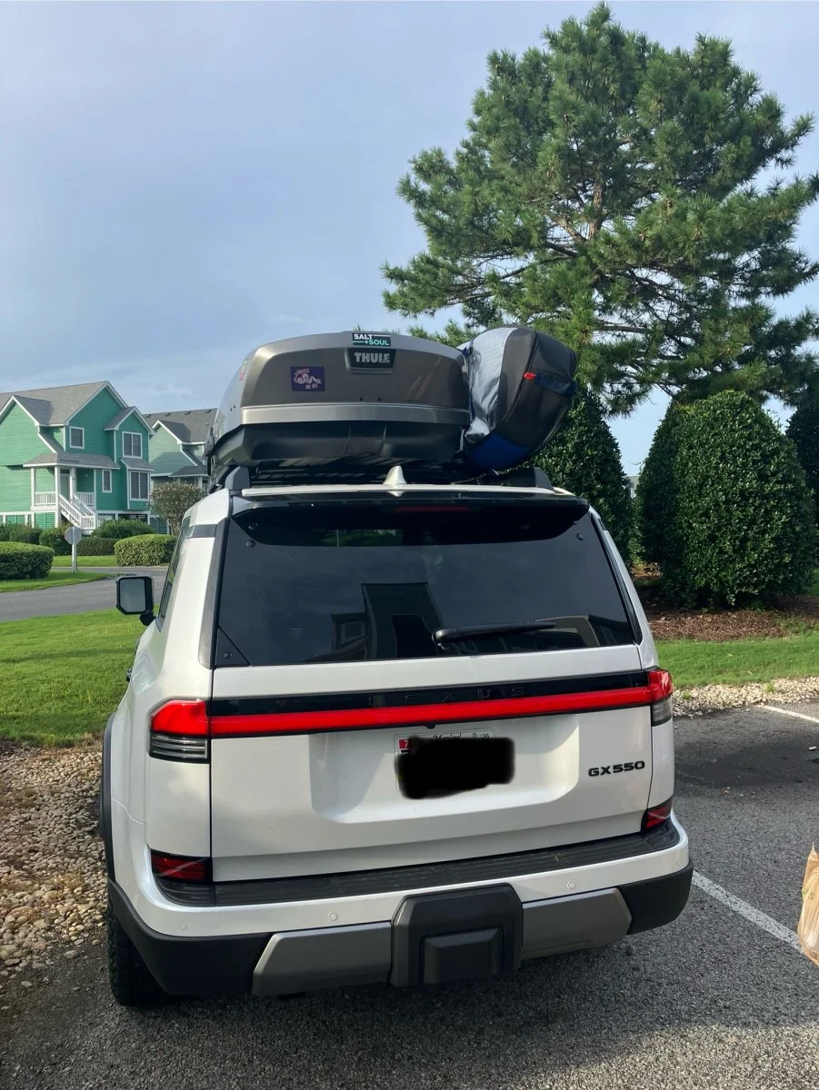

Back from OBX. My OT+ fully loaded road much better than when unloaded. A Thule XL roof top carrier and a 8' downwind board strapped to the side proved to be quieter than just the stock cross roof bars. At OBX with the roof top on but unloaded it still appeared to drive better than unloaded. Returned home, unloaded, roof top carrier and cross bars removed and the truck is remarkably quieter at higher speeds however, the rough ride has returned on rough pavement. Would seem to me to be the suspension set up. Specifically the rear. Just seems a bit harsh to me. I wouldn't call my rough ride, vibration, but I think most feel a "Lexus" even if it's an off-road version would drive, well, more like a lexus. That said, I really like the truck and will be looking for a mod that smooths out the rough ride a bit. I'll bet taking it to the Annapolis dealer to see what they have to say and seeing if Lexus comes out with a fix for all the complaints they would appear to be having or soon having.
325 mile each way. 18.6mpg driving 70-80mph with the roof top carrier and board. I didn't punch it on the starts. I did notice 22.3 mpg when driving at 55 when leaving OBX. Again not punching it on starts.
