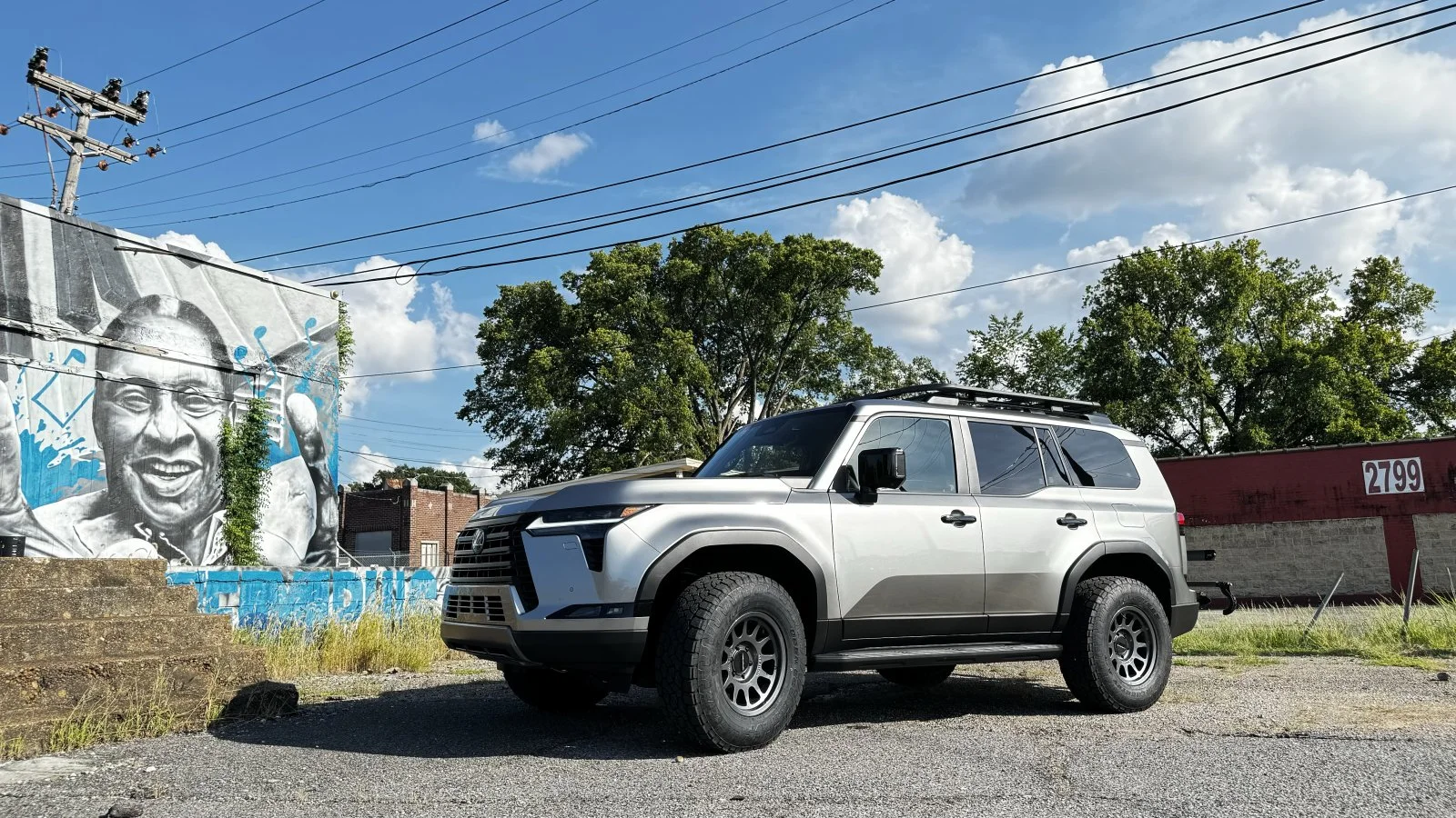

What size tire did you put on?
285/70/18
Snug fitment up front. Barely rubbed the lower cover (w/ the three plastic push pins) behind the front passenger tire at full lock. Removed the cover from both sides. No rubbing anywhere now.

No lift? Any pictures? I keep hoping to see if those tires would work on the stock rims.
No lift.
I'll post pics over in the aftermarket wheel thread when I have time to upload some decent pics.
Somebody with a Nori has that size on Overtrail wheels. They fit fine and look awesome.
No lift.
Actually, these are 285/75/18.
285/70 no lift.
