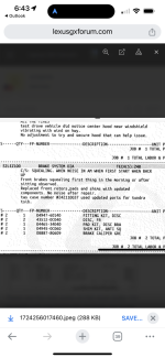

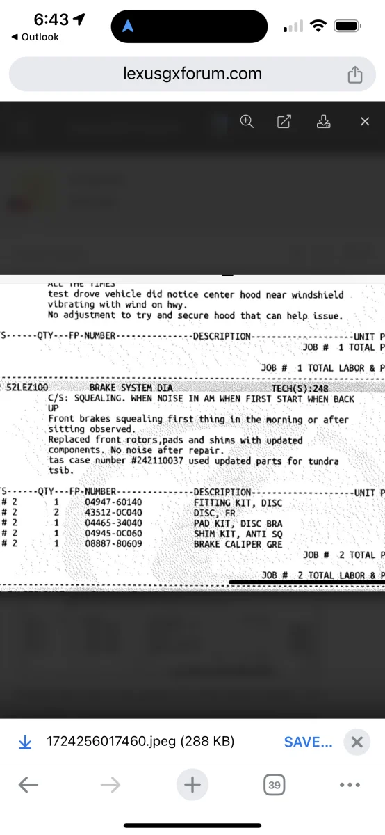

It would be great if some of you told your dealer about the brakes to see if they fix it and it works
If she doesn’t come back on, from Alabama.
@sroberts, who and where is your dealer that did the shim replacements so others have the option to go there too.
My dealer in VA acknowledges there is a brake problem and says they are waiting for upgraded parts from Lexus. They don’t acknowledge the vibration issue officially but said it might be good to come in and get it down on the record. No fixes for either for me.
