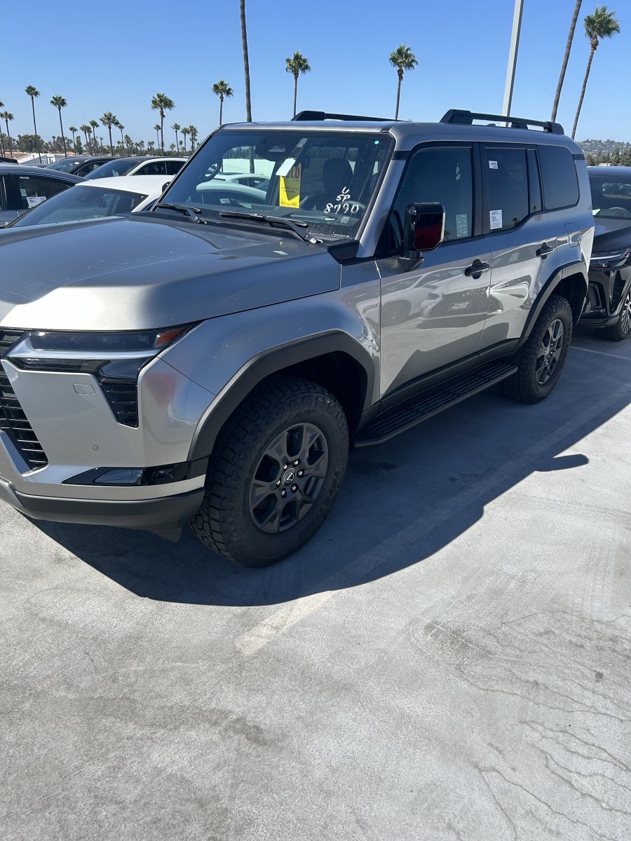

Gulp!! My dealer just phoned. My OT showed up early! Hope this thing doesn’t have speed wobble:ROFLMAO:
