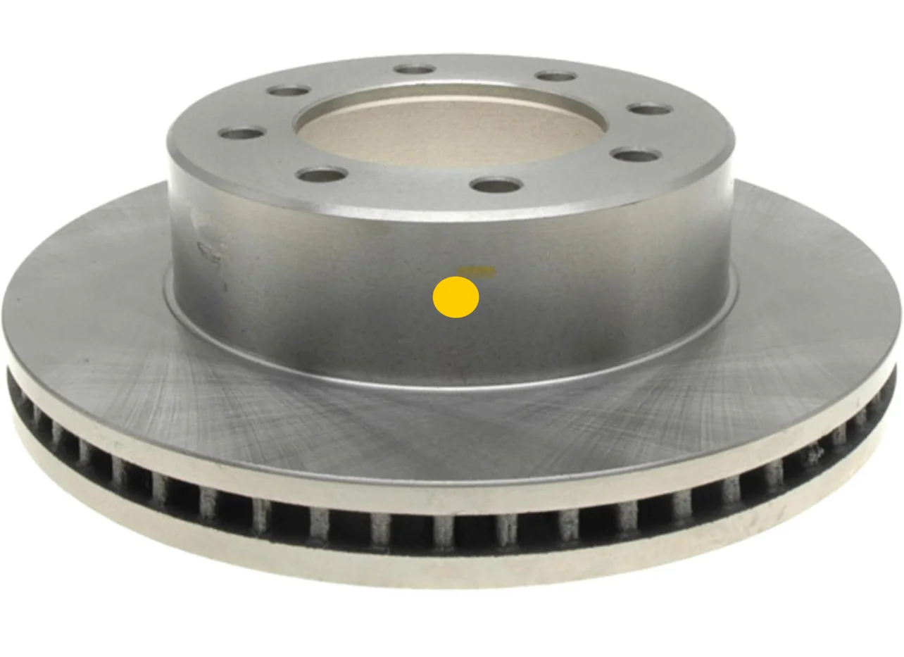

I must have missed that post on the squealing brakes thread. What, why, and where am I looking for a gold dot for on my brakes? I’ll go take a photo and post
I was the one who posted that pic and it was clipped from a video of the Tundra brake rotor TSB. The gold dot indicates “updated part” and is located on the horizontal flat area between the disc and hub. See pic.
I made the dot bigger and brighter than it actually is in person so keep that in mind when looking. It’s actually quite small…
