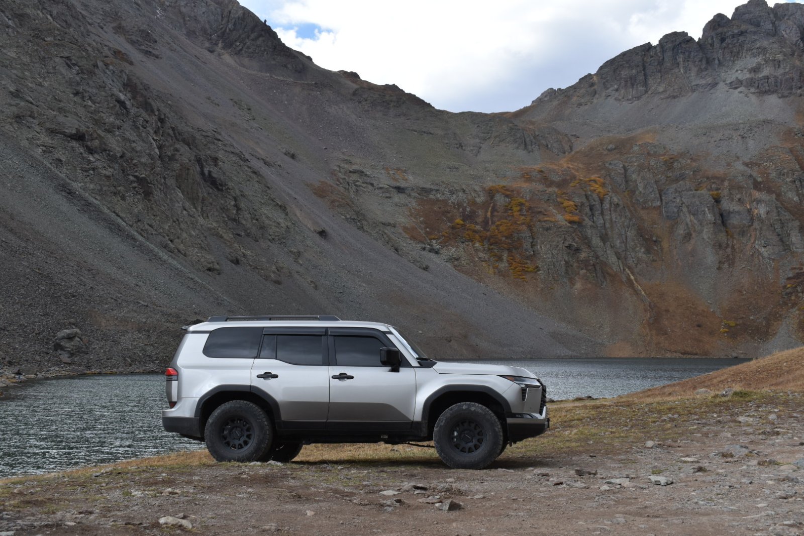

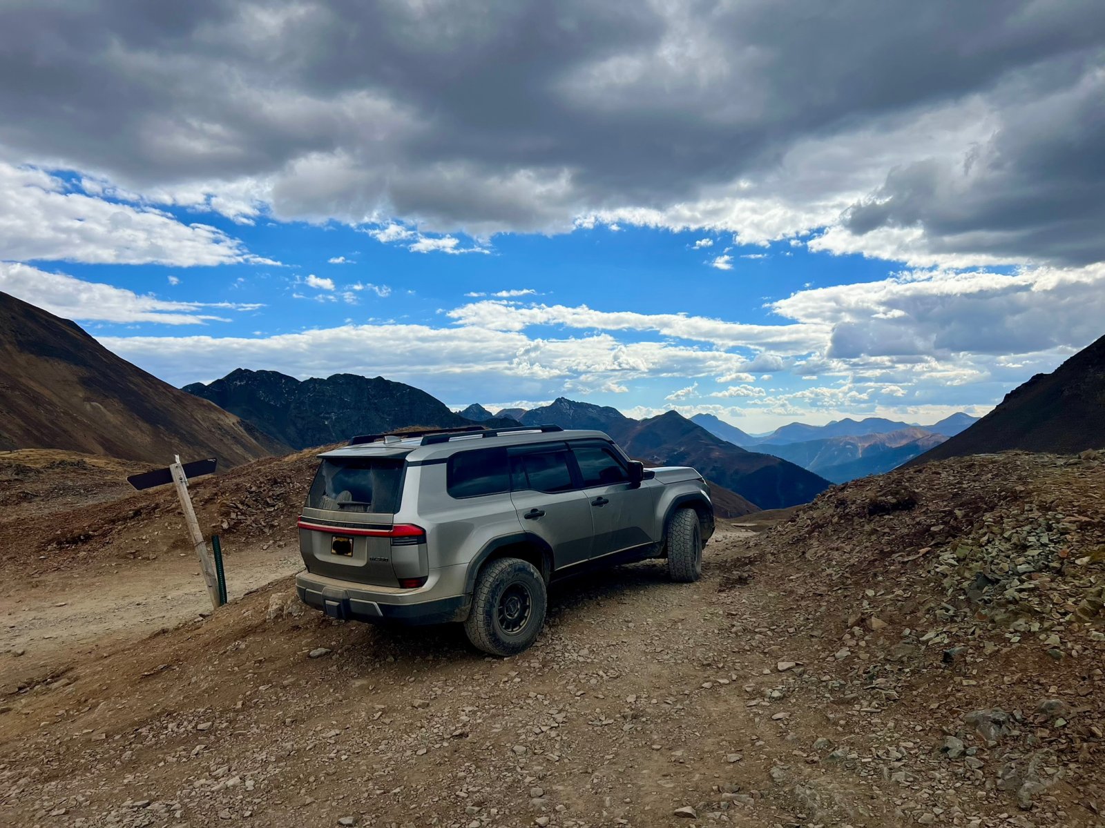

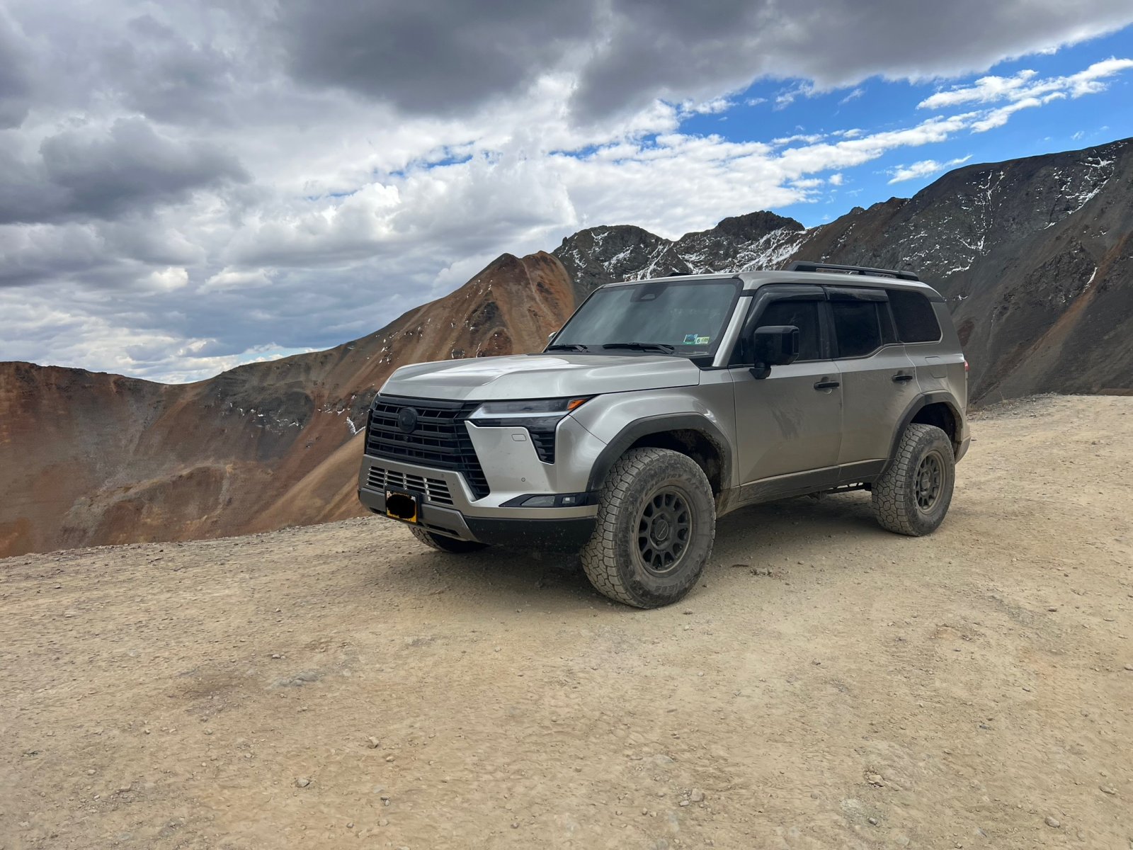

Hi all, good info being passed along! I am currently on a 5,500 mile roadtrip with my OT. Been dealing with the vibration issue since day one, been to the dealership multiple times and have a ticket currently open about the vibration issue, always slapped with the ole “this is a normal driving characteristic for this vehicle”. Having already done about 3k miles on the highway in the last 8 days, I can say that the vibration is much worse at 70mph or above. I have had 4 sets of new tires and wheels, all road force balanced and no fix. HOWEVER, on a positive note. I just got done doing multiple trails in Moab and most of the Alpine Loop in Durango/Silverton/Ouray Colorado, and this thing offroad is an absolute beast! Obviously 90% of the driving that I will be doing will be in the highway, but if you get a chance to take it offroad, you wont be disappointed. Ive been pretty irritated with Lexus over the past few months, but this past week surely took my mind off the vibration. My Lexus case manager has set me up an appointment with an engineer this upcoming week to hopefully get the issue figured out. Im in the Northern Va area, so if you’re in that area hit up Lexus as the engineer will be in town from 10/7-9..
