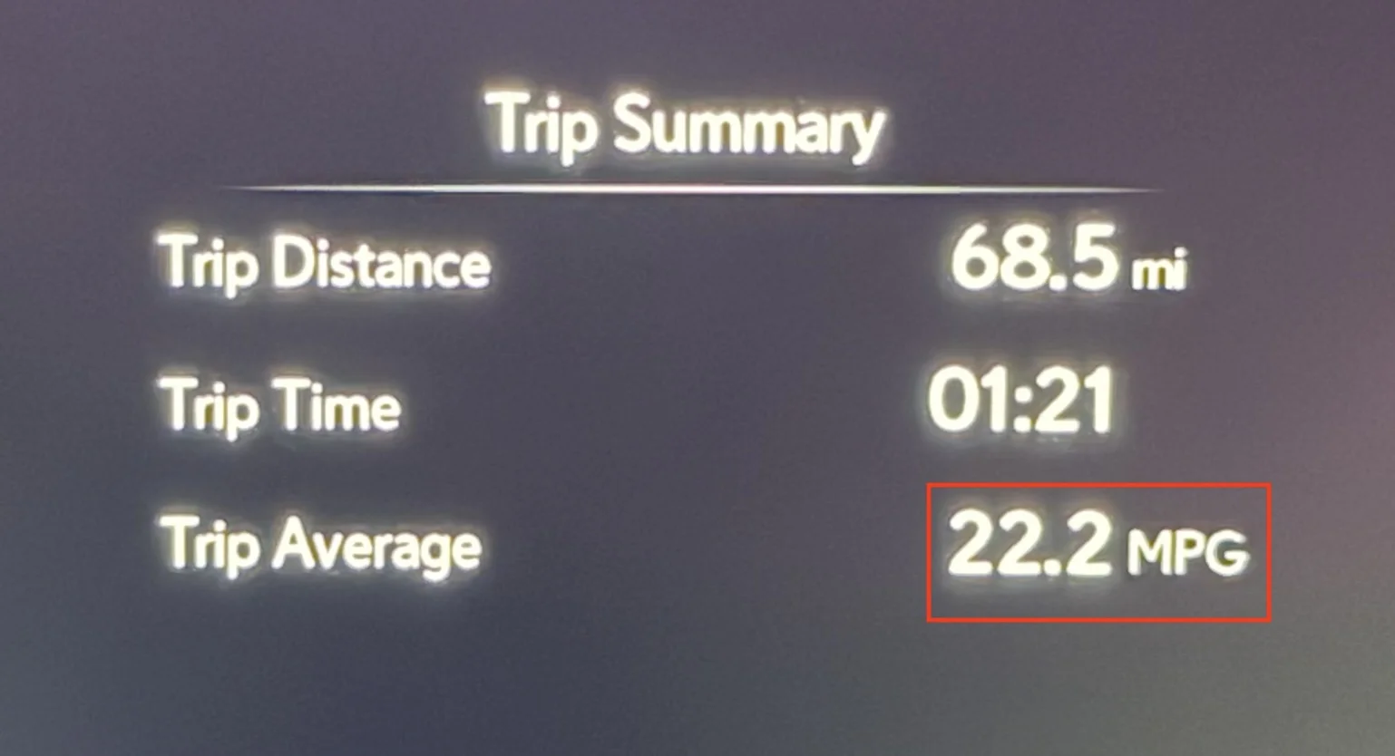

Still loving it. I'm on the 93 octane tune and there's a NOTICEABLE improvement in part throttle driving. Tip in is smoother and there's just more urgency/torque everywhere. Fuel economy better too. Currently averaging 16.6 mpg between city and highway.
Never saw these kind of MPG numbers before the latest tune.

I haven't looked at MPG, but I'm loving the new tune. Especially the transmission. The GX drives & responds like it should have from the factory. Off-on throttle lag is reduced, and my biggest OEM gripe - stop sign response - is night and day. I really disliked how every time I came to a stop sign & went to take off there was a big hesitation, like the transmission was still trying to downshift to 1 or 2. Now when I hit a stop sign and go to take off the GX is (almost always) ready to take off. So. Much. Better!
Those MPG numbers look fantastic. I am happy to hear you guys are liking the new tune. It is a combination of completely rewriting and recalibrating load / boost targets, throttle, torque, transmission shifting, and more.
Those MPG numbers are better than what our hybrid Tundra could do.
