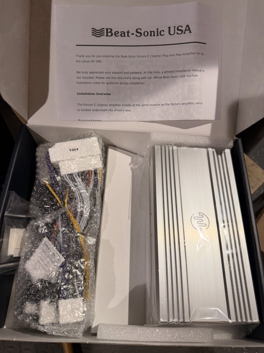

It's arrived....will try to get this installed tonight.

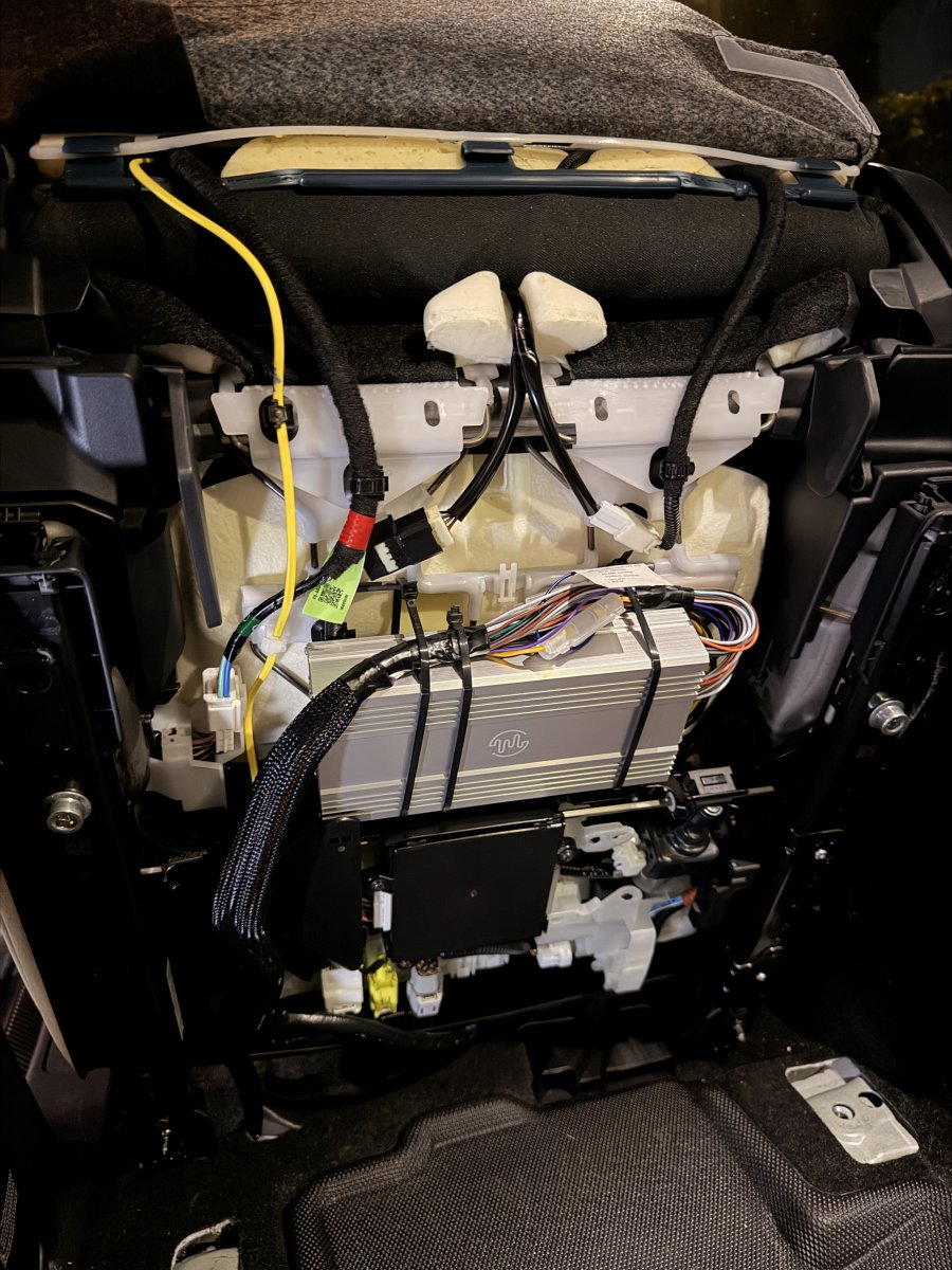

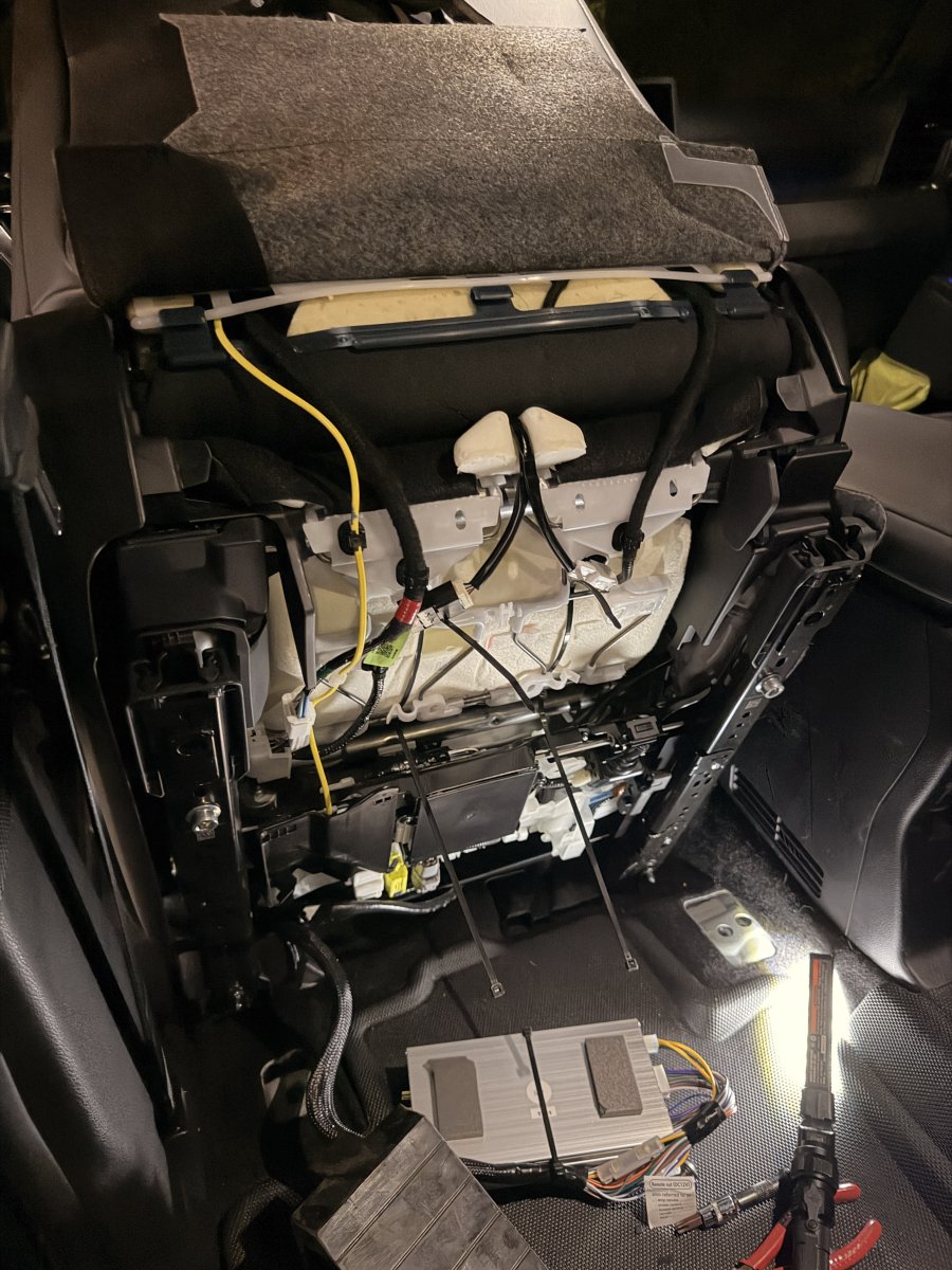

Some quick tips for install

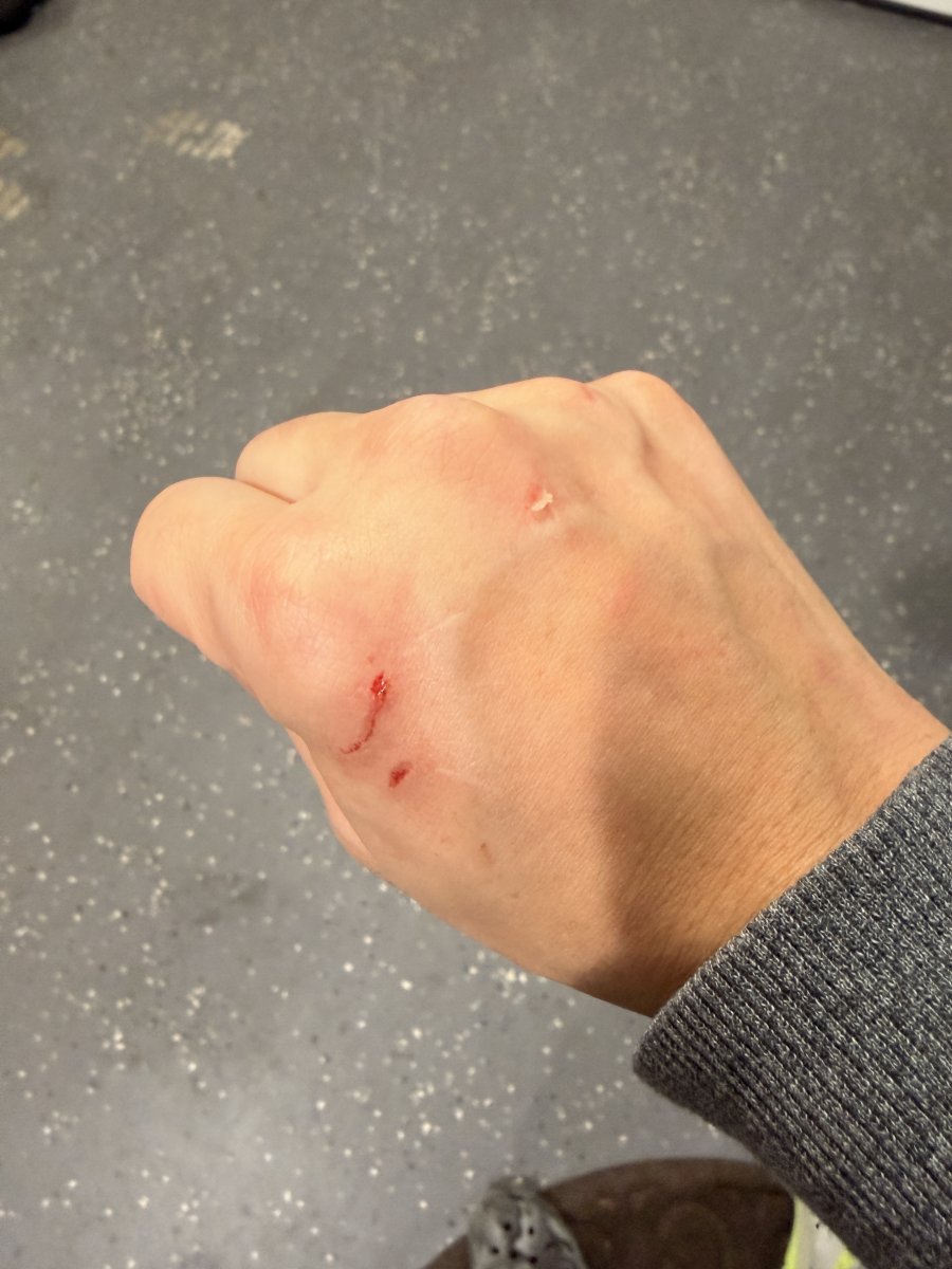

  • Your hands will get mangled under the carpet. The plastic pieces are sharp!
  • play with the latch on the beatsonic harness to see how the mechanism works so you know how to remove the stock plug from the stock amp.
  • when installing the harness, connect to the stock amp first before connecting the harness to the stock cable.
  • tilt the seat forward (against the steering wheel) to access the bottom of the seat to mount the amp. It was near impossible for me to do anything with the seat flat.
