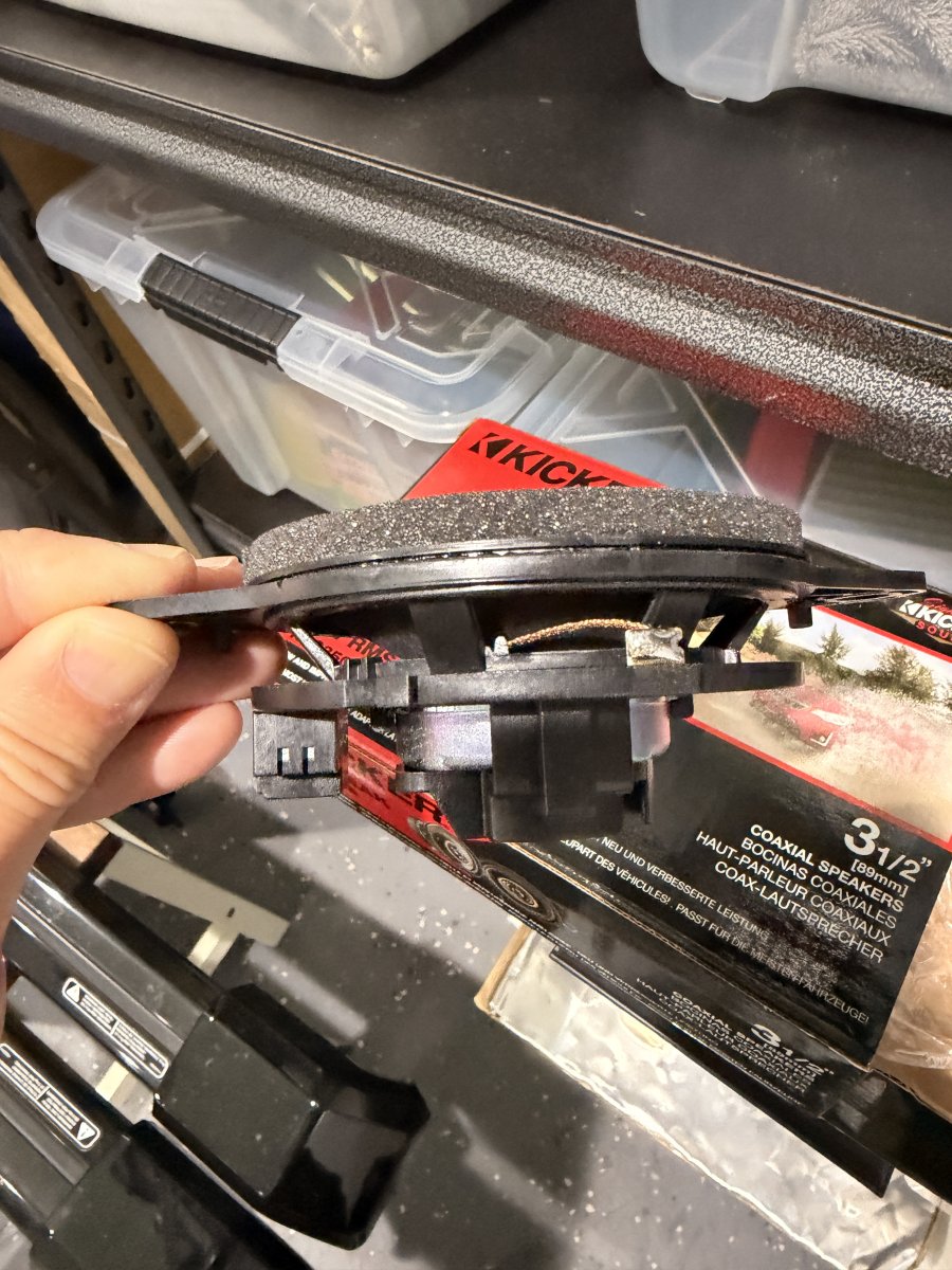

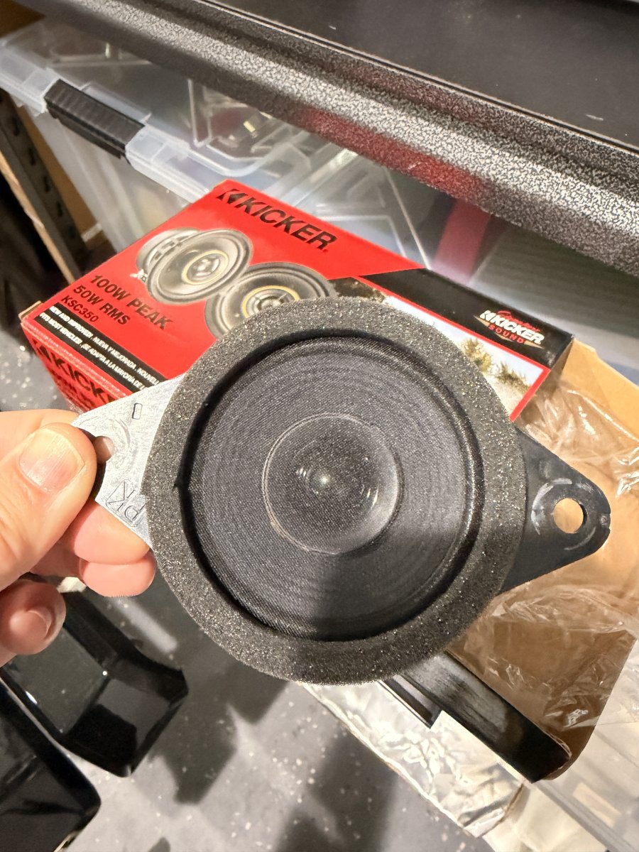

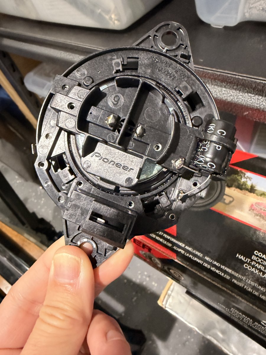

Did the OEM speakers you pulled out of your GX look as cheap as the ones in the video?
