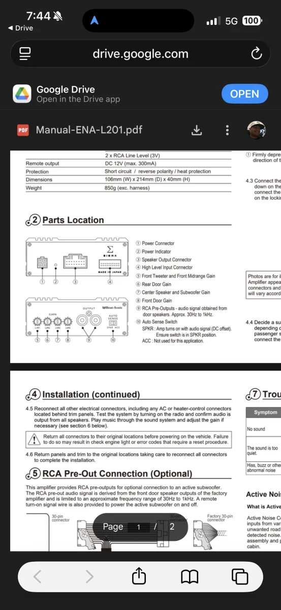

This amp in the way it sounds has moments where it sounds strange
(5) Front tweeter and door gain …. This I get I think
The front door gain (8)
Is this amp just bridging power to the front tweeter and door speakers?
