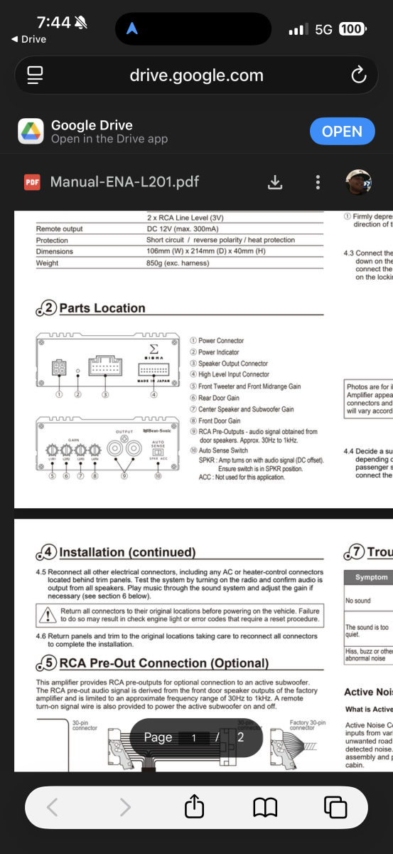

With the RCA preout, I assume that allows you wire directly to an amp for a sub without having to use a LOC? Is there a remote turn on wire as well? Of course it's out of stock now that I have my GX and looking to purchase.

Little update here for anyone that is looking to utilize one of these with also adding a sub...using the RCA preout from the Beatsonic amp to the subwoofer amp does work, but the problem is the factory head unit bass adjustment controls the bass level of both the factory speakers AND the subwoofer. This is obviously an issue, as with the factory setting set high enough to have sufficient output from the sub, the factory speakers are pushing too much and distort. Set it down enough so that the factory speakers are good and the sub doesn't have enough output for certain genre's and songs, and that is with the gain on the sub's amp maxed out.
I reached out to Beatsonic and there is nothing their amp can do to mitigate this as I assumed, so it seems like the preout is a bit of an afterthought. I'm going to try an LC2i PRO and see if that will fix the problem, but if I'm having to use that it really defeats the purpose of running RCA from the Beatsonic. Just a bit of warning if that is a big selling point for anyone.
