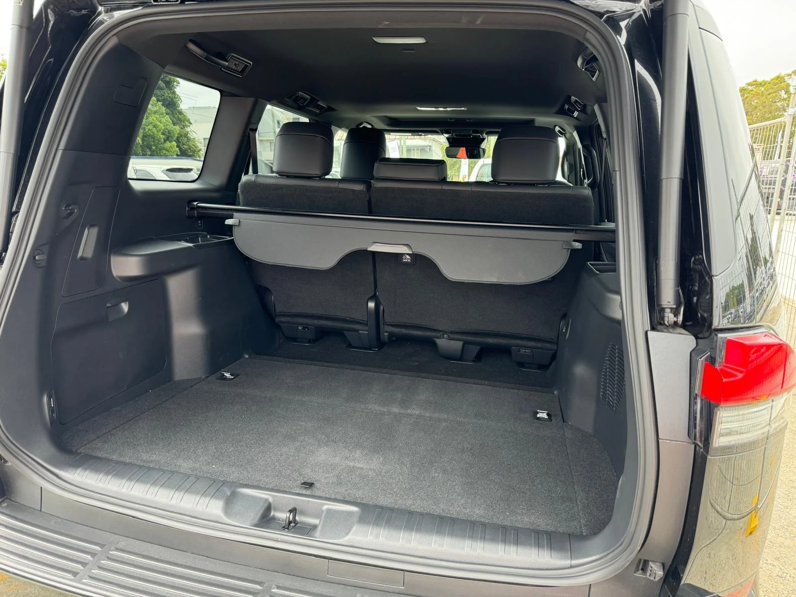

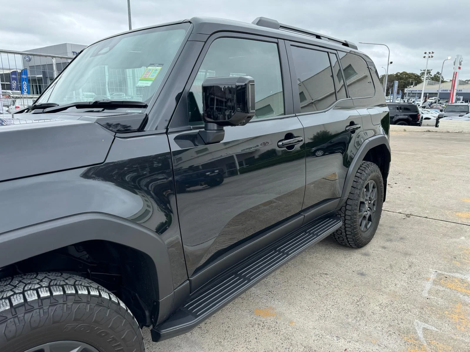

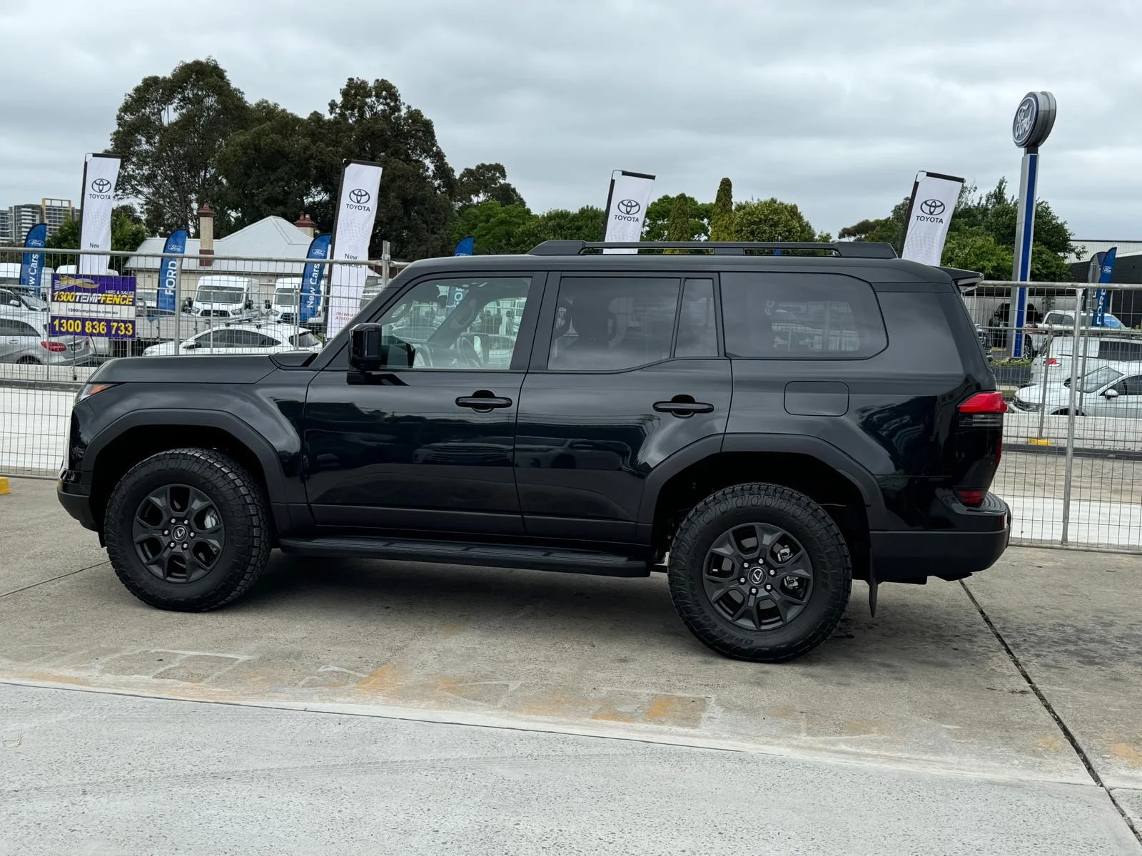

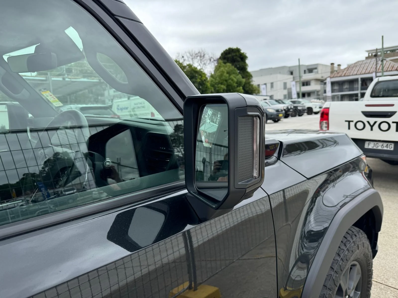

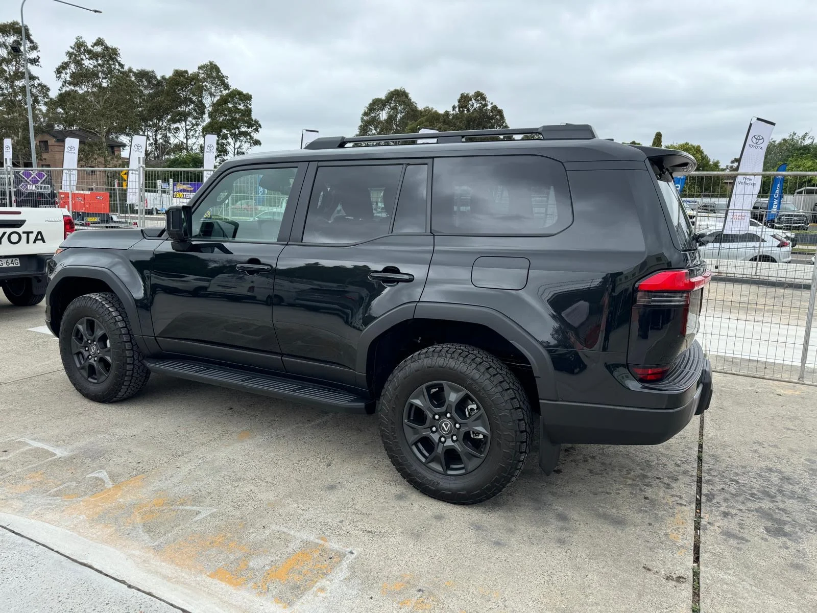

I took a test drive in the OT here in Sydney and I could certainly notice the vibrations in the rear on the main road, their excuse was that’s what a body on frame vehicle feels like. I have driven plenty over the years and they have not felt this bad. It was not as bad as a previous post where the water was bouncing all over the place. I pick my new OT up on the 6th Dec, fingers crossed that does not have the vibration issues. Pics of the test drive car attached just for interest and no Sydney does not usually look this overcast! 😀👍.
