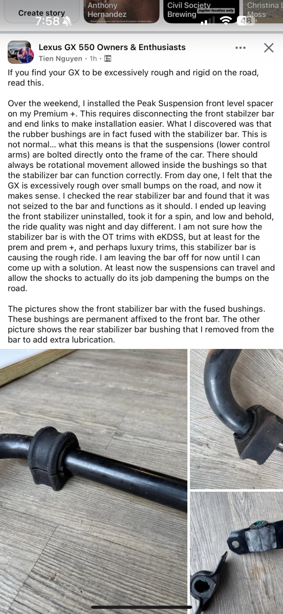

I have aftermarket suspension now and I believe it is NOT the shocks or springs. I think it may have something to do with the sway bar connections. Trying to figure out how to temporarily disconnect them, physically do that. Not just pull the fuse, to see if it changes.

eKDSS does not disconnect the sway bar. What it does is relocate the point (rear) or points (front) that the sway bar connects to the frame. This allows one side of the front or rear to droop while the other side compresses, or vice-versa , without twisting the sway bar. But if the fuse is pulled during one of those conditions and the eKDSS can't relocate back then it will be the equivalent of twisting the sway bar with both left and right sides at equal compression, thus transferring more weight to one of the wheels.
If you want to test and see if eKDSS and/or the sway bar is involved, just remove the sway bar end link from the knuckle on one side (left or right). You could do front and back at the same time, or do one then the other then both. Typically off-roaders will tape or zip tie the loose end link to keep it from swinging around and getting damaged.
