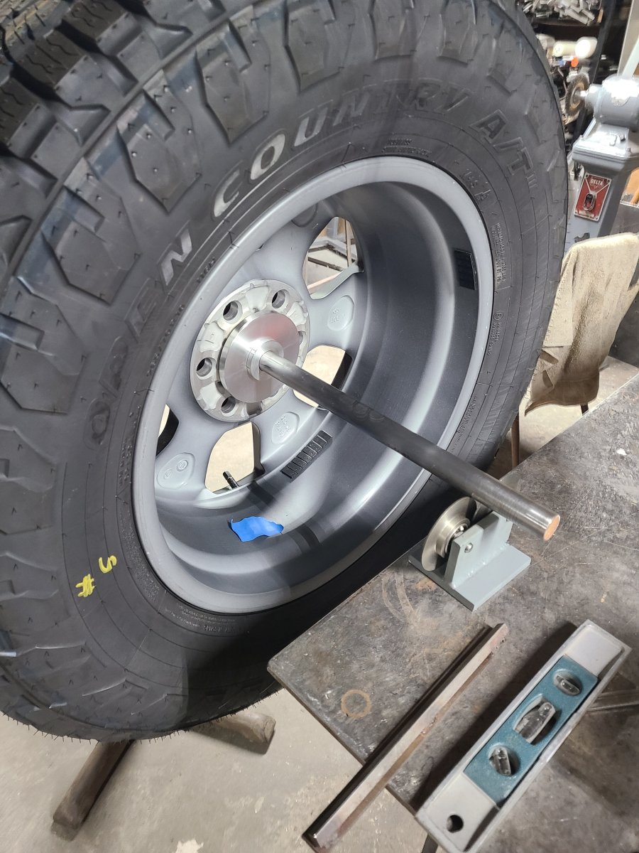

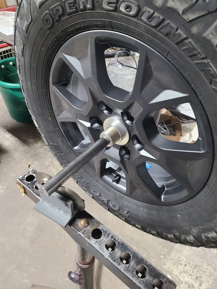

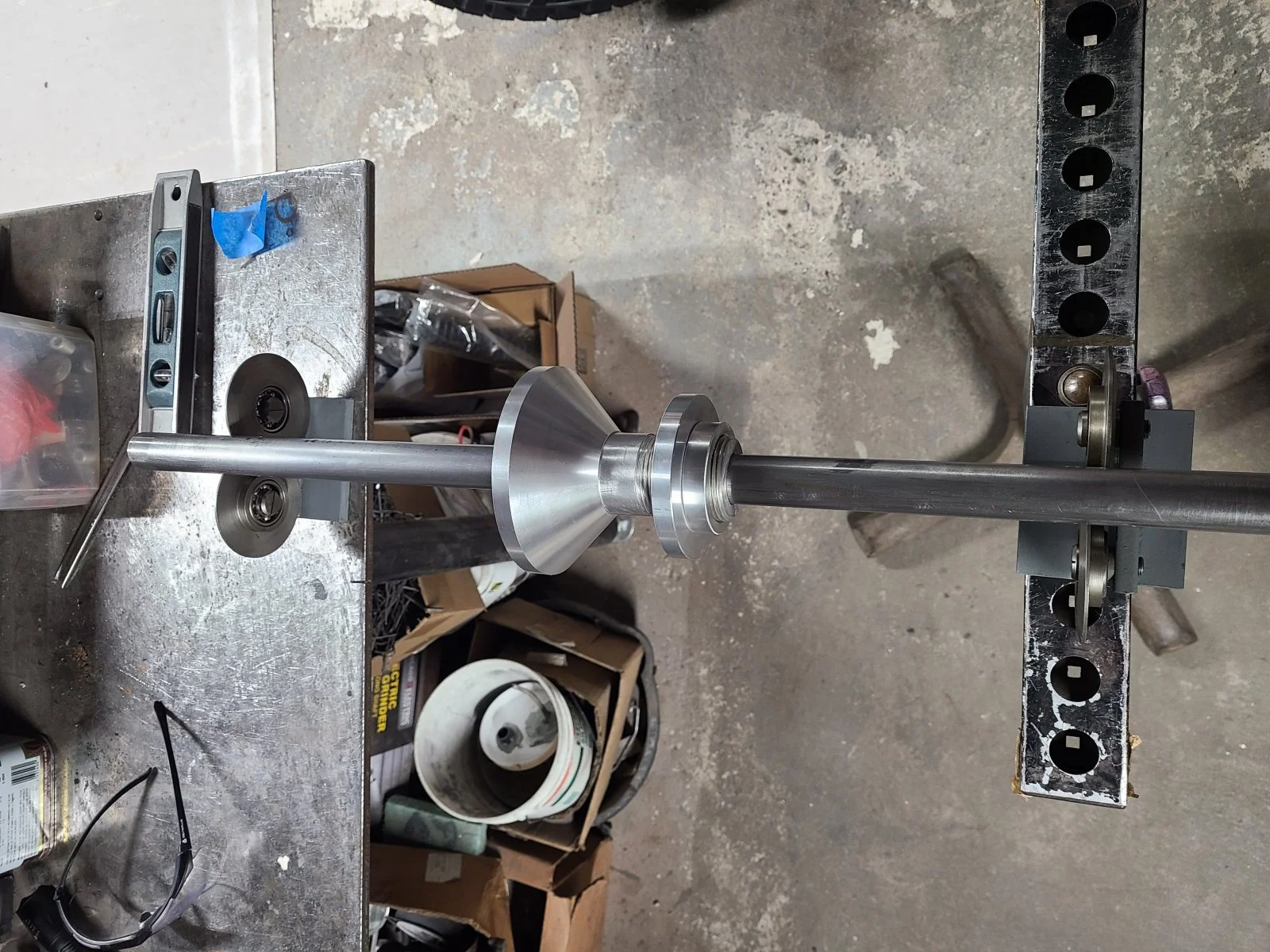

The wife started to "notice" the vibration so I checked the balance today on all 5 tires (515 odo). I have a set of balancing bearing blocks on which I can place a shaft thru the wheel hole/hub and gravity will define the heavy side. I had to make an adapter for the Lexus wheels and it now works great. My findings: #1 wheel was on LF and needed 29g of tape weight to balance. #2 was on RF and needed 31g, #3 was on RR and was OK, #4 was on LR and needed 24g, and #5 was my spare and was OK. According to Google, the wheel should be re-balanced if 5g or more would be needed. My balancing equipment seemed to be sensitive to 1-2 grams. I took a test drive and all seems nice and smooth - a GOOD thing! (y)
