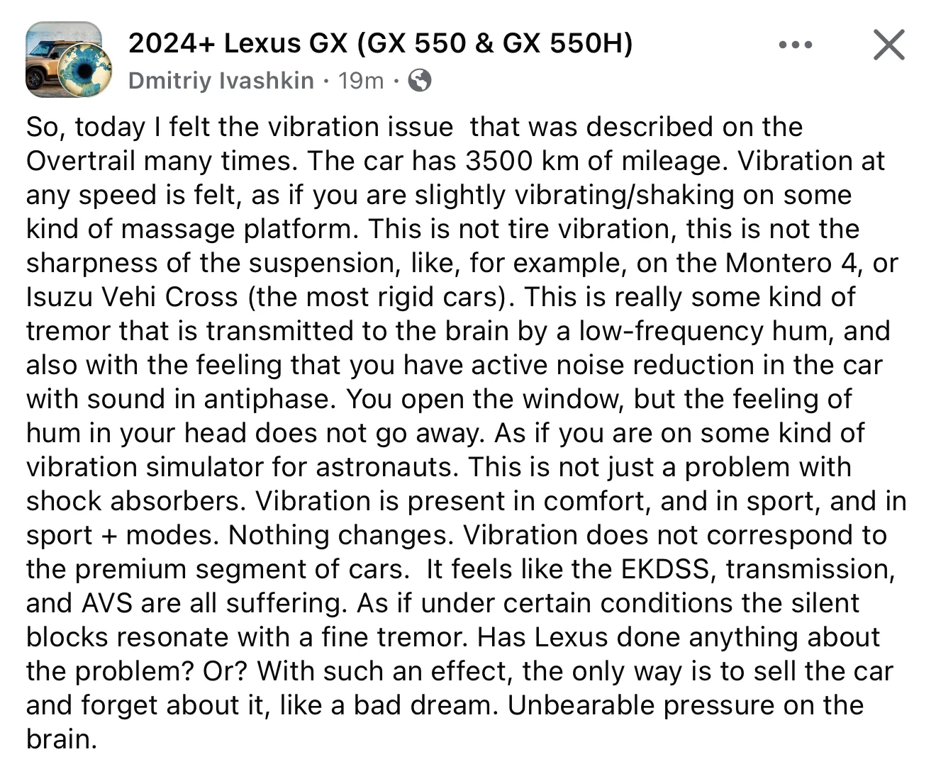

Saw this on FB. Not sure if they’re on here but man it sounds rough

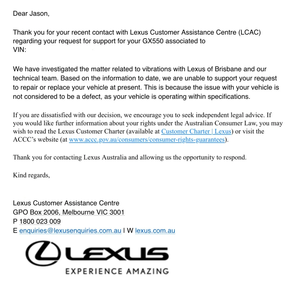

Well it’s been a while, but I do have a bit of an update… Spoiler alert, it’s not resolved.
I have been back and forth with Lexus Au and the response has been poor. Basically, they refused to perform the tests with the vibration sensors that they said they would do. All they did was send me a letter to say that basically, what I am experiencing is standard.
I reached out to Toyo Australia and the response from them was fantastic. They offered to get the wheels Road Force Blanced for free, and arranged a time for me to drop over to Tyrepower Morningside (Toyo agent here in Queensland Aus). Matt was really helpful and balanced the tyres which as reduced the vibration, but it is still there. (And once again, it is a different vibration to the harshness of the OT suspension).
So, massive thanks to Toyo Australia and Tyrepower Morningside, your customer service is far superior than Lexus Australia.
I have just purchased a full set of Wheels & Tyres off another owner that has just changed over to 34”s. According to him, he had no noticeable vibrations. Hope to try them out when I get back from my USA trip in a week or so. .
Anyway, here is the response I got from Lexus Au. And forget the ACCC, they are a toothless and clawless tiger…
