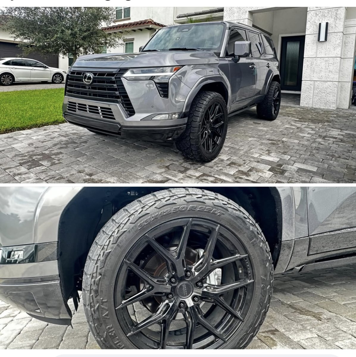

I want to maintain the stock tires and just get a better set of 18” wheels. I think the thickness of the wheel is what is confusing me then. I want a set of 18s that sit very slightly outside the body like maybe an inch. Something like this pic. In the picture those are 22s, but I’m just talking about the stance, not size of the actual wheel.

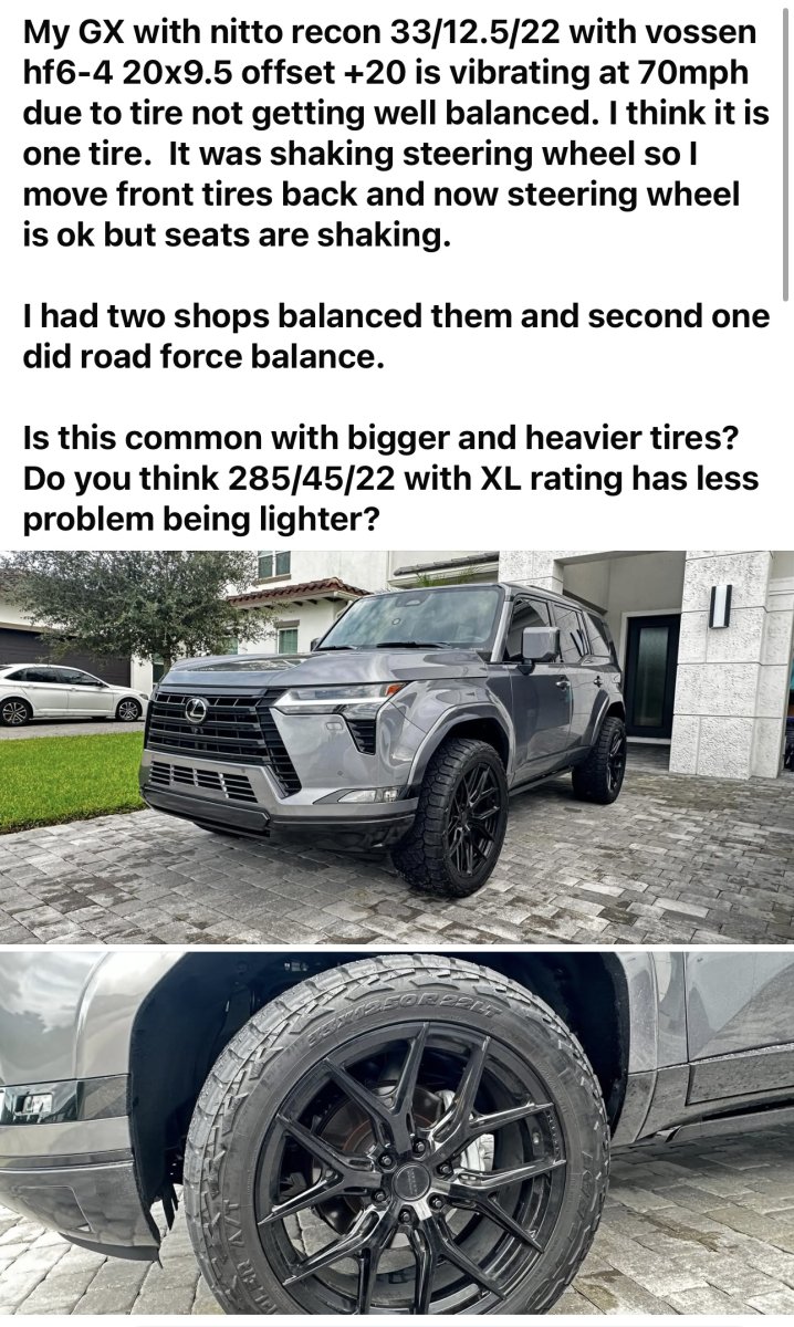

Here is an example of what I’m talking about. This is on another forum, but they says 20x9.5 +20 offset, and that stance is perfect to me, but I thought positive odder would sit closer to the body. Clearly I’m an idiot missing something here

Yes, +20 offset is less than +35 or +50. So +20 will stick out farther than +35 or +50. How far? The number indicates millimeters, so going from stock (+50) to +20 means you lose 30mm or a bit over an inch (25.4mm).
Oh boy …. First and foremost do not listen to that shop …..second what fitment do you want meaning where you want the wheels to sit … to me .+20 with a 275/70R18 is perfect … but thats just me …… people will say lift and you can clear a 285 but I think that’s BS…. Lift doesn’t help articulation. It just helps you ride around the mall but when the suspension moves past that daily driving movement point per day you will rub and it will not be pleasant
