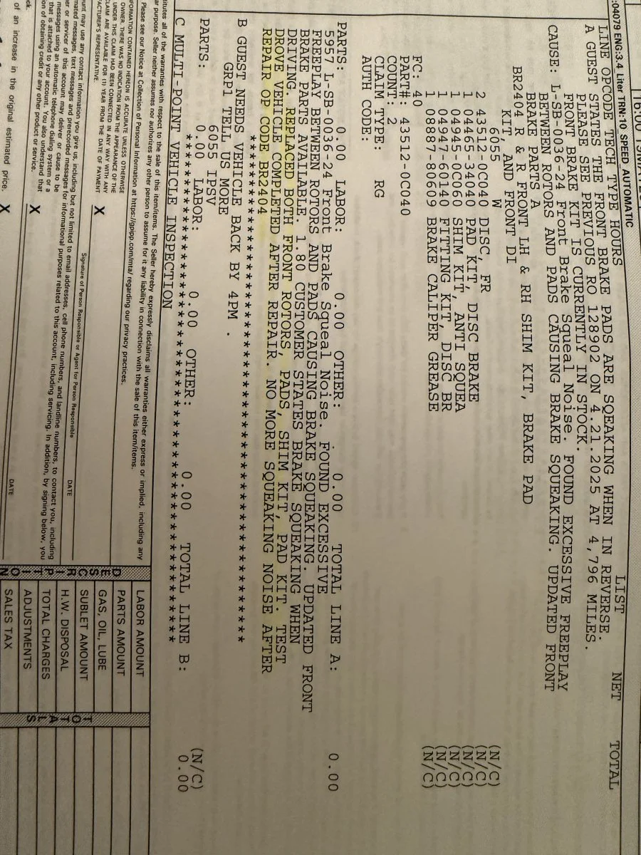

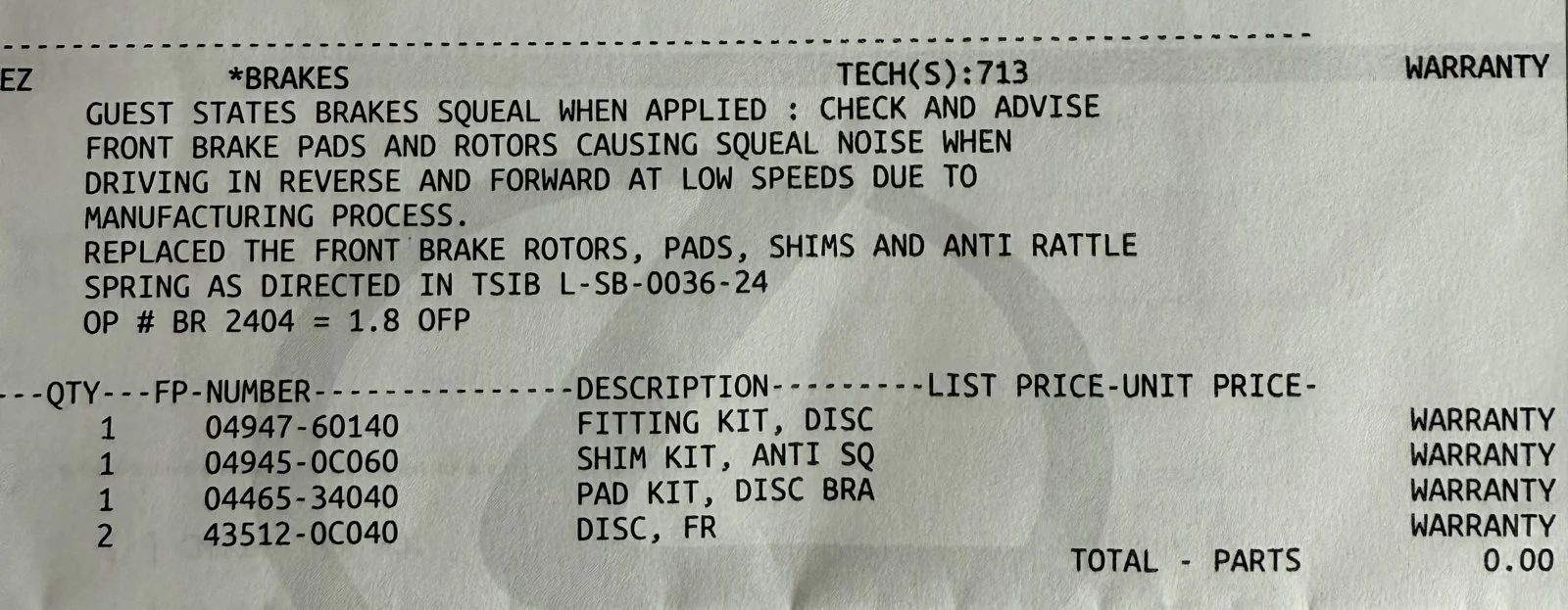

Mine started just before 5,000 miles. Mainly backing out in the morning going to work. If it does happen it’s good to know Lexus will fix it no charge. The tech found excessive free play between rotors and pads causing the squeaking. The whole kit consists of rotors, pads,shim kit, fitting kit, and brake caliper grease
Got my brakes fixed today by Newport Lexus. Squealing brakes started at 3,000 miles. Took 2 months to get the parts. Now at 14,900 miles I have silent brakes again.
Parts Installed:
2 DISC, FR
1 PAD KIT, DISC BRAKE
1 SHIM KIT, ANTI SQUEA
1 FITTING KIT, DISC BR
1 BRAKE CALIPER GREASE
