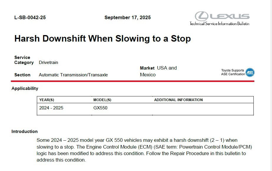

Transmission Clunk TSB L-SB-0042-25

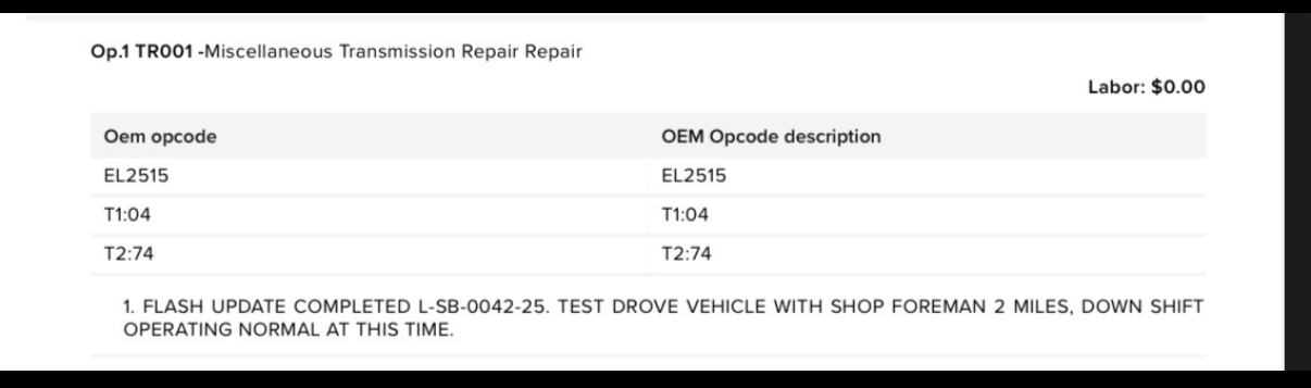

Had mine updated as well. No more harsh downshift. This is what was mentioned on the invoice:

If anybody is wondering if recently produced 2025 GXs can have the calibration applied, you can! Mine was produced in July 2025 and I had no problem getting the dealer to flash my ECU.
Make sure you give your dealer the updated TSB number: L-SB-0042-25. The old TSB L-SB-0031-25 was a preliminary one which I believe dealers now cannot access or reference.
