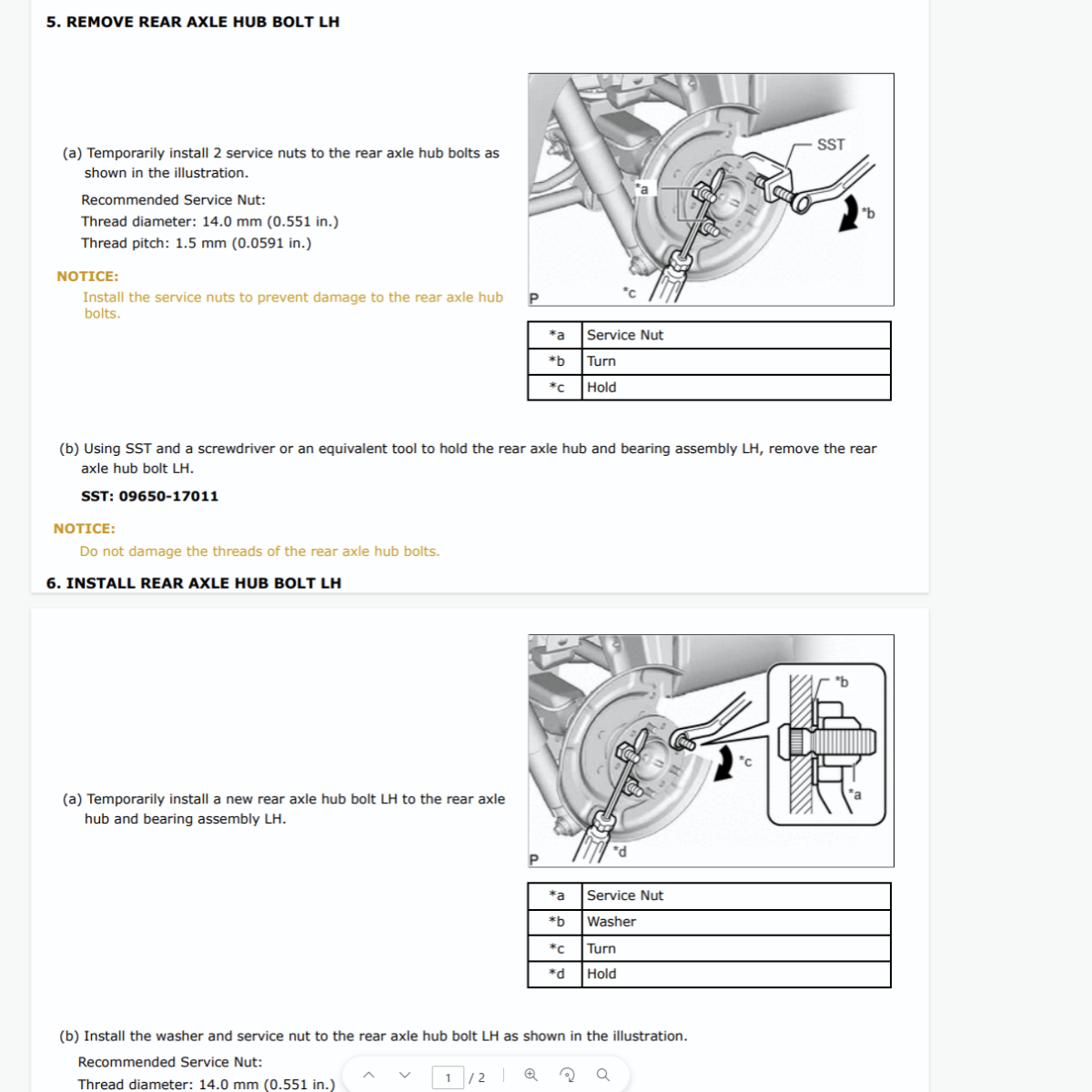

Both the front and rear hub bolts are removed/installed with hand tools. Looks like it's straightforward if things aren't too rusty.
There's a SST for removal but it's interesting that Toyota's installation is how DIYer would do it with a washer and nut.

I was unable to find that SST in stock anywhere but I think I can get by using a ball joint press. DONT HAMMER OUT THE OLD STUDS WITH A SLEDGE because there is a non-zero chance that you will damage your hub bearings.

I just find it interesting that Toyota doesn't recommend a SST for the install since most recommend pressing in the studs as the official way of doing things
https://www.amayama.com/en/part/toyota/0965017011 - Amayama has the tool, shipping's a bit expensive but I'm probably going to order it since I have a bad habit of collecting tools I only use once in a blue moon.
