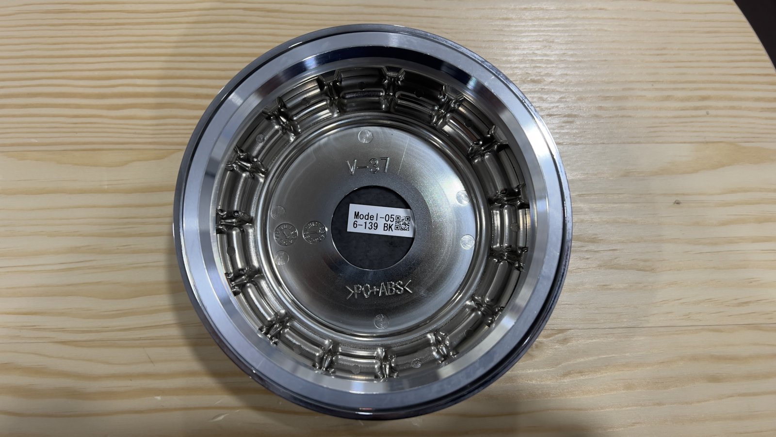

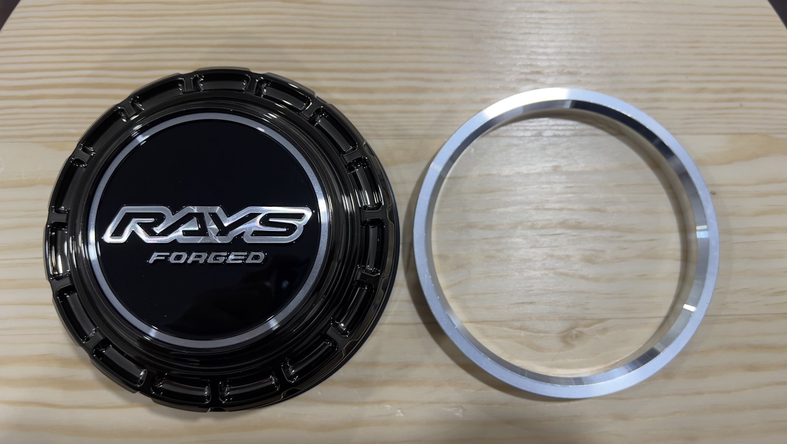

Just received the hub rings. The rings fit pretty well inside the center caps.
Hoping this setup will allow the mounting of both center caps and hub rings.

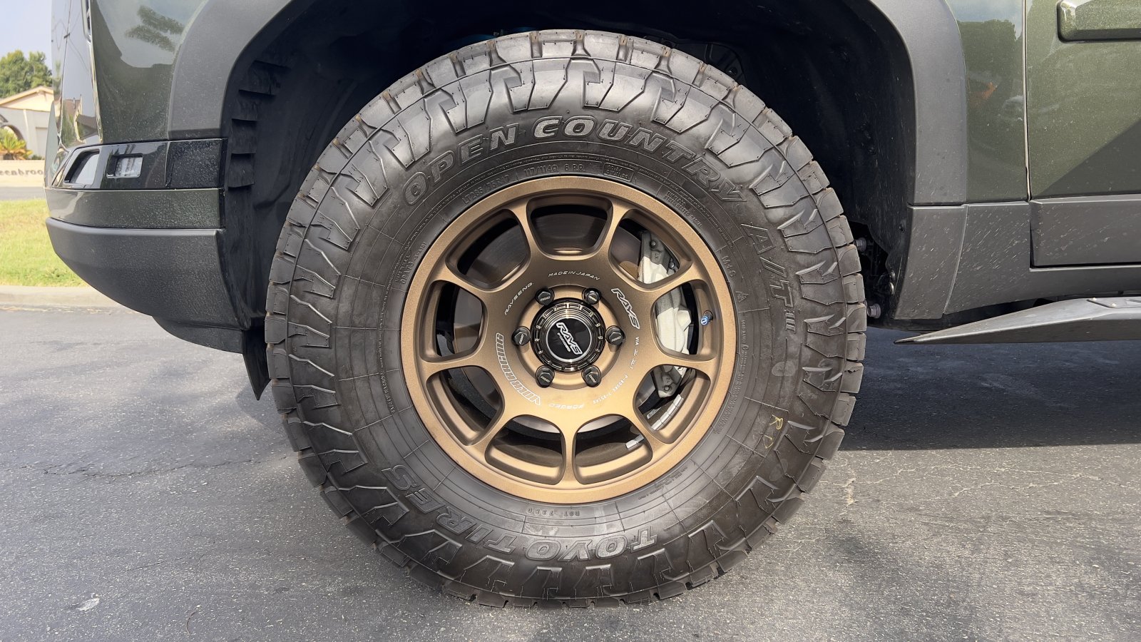

I just finished installing the Rays center caps with the 106 mm to 95.1 mm hub rings. It worked!

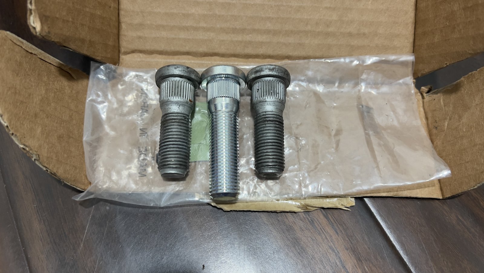

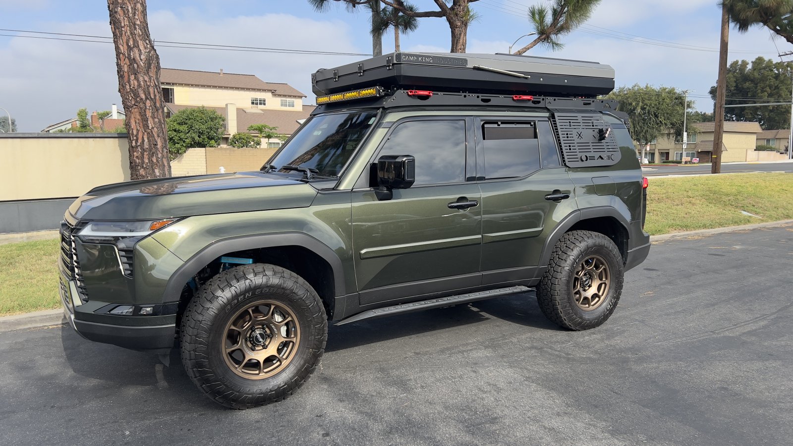

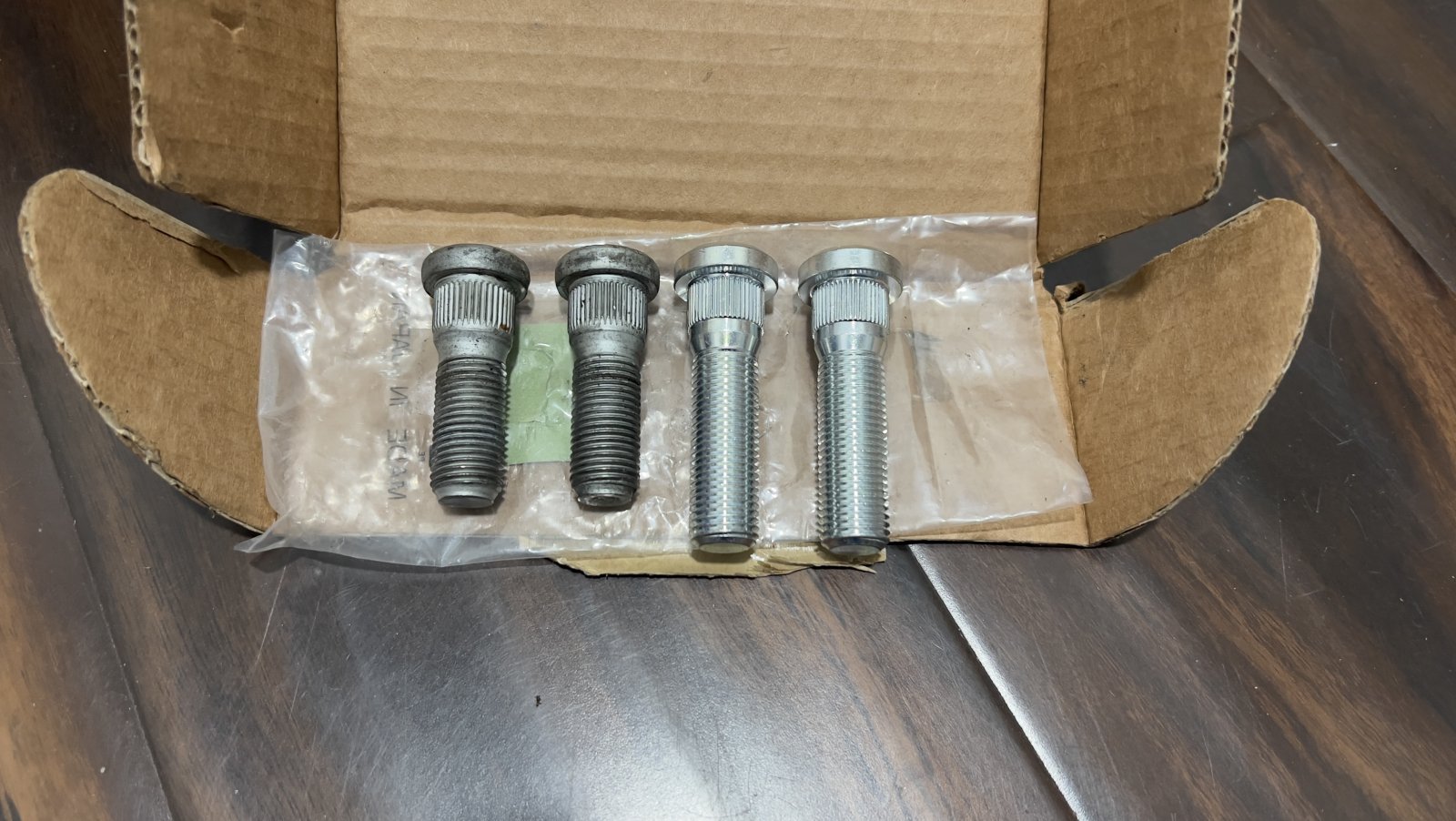

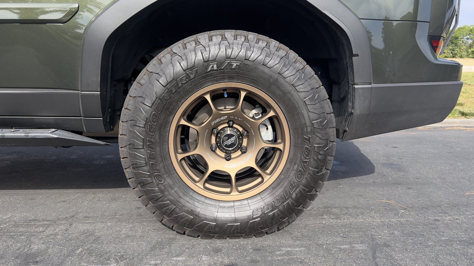

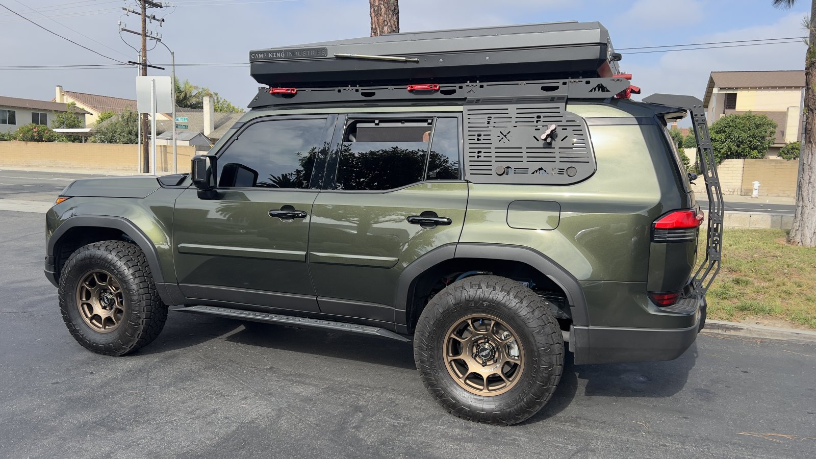

Removed the 112 mm to 95.1 mm rings. Here are pictures of the OEM studs compared to the extended ones as well as the finished product. Since I didn’t perform the install, there are no pictures of the extended studs mounted on the wheel.

Brah….that’s a sick ride. The Volks bronze and Nori green compliment each other. Making me second guess my color options. The hub rings you got are aluminum or polymer? Last night I went over the whole thread again and bookmarked all the links to the items mentioned. I’ll consolidate them in a post later to make it easier to reference.
Aluminum. Would recommend Wheel Connect or NYTOP 106 mm to 95.1 mm hub rings.
How many full turns now with the extended studs?
9.5 turns. You will get close to 1/2" more thread engagement with the Kyo-Ei extended studs. The ones from eBay are longer so you will get more engagement.
