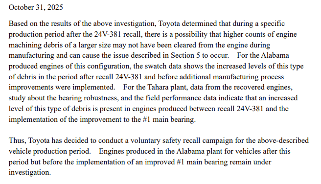

This file contains more info on the timeline of events: https://static.nhtsa.gov/odi/rcl/2025/RMISC-25V767-8528.pdf
So based on this it seems like engines made after this period and up to when an improvement in the main bearing was implemented remain under investigation. I didn't see a mention of when the improved bearing was implemented.
I found something somewhere that says the Car Car Nut guy mentioned the bearing PN was updated in April of 2024, which would correspond to this new recall where engines up to new bearing being implemented are being recalled. The wording about others remaining under investigation appears to be because this recall only covers Tundra engines made through February, not April like the LX and GX which would correspond with the updated bearing design.

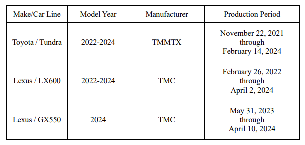

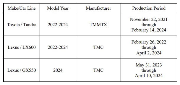

Based on the recall sheet they are recalling 3800 GX's made between May 31 and April 10. So in a period of 11 days that's 345 GX's a day out of Tahara, in addition to the other Toyota and Lexus models rolling out of the plant that don't use the V35.. I doubt they are storing 10's of thousands of engines somewhere that could lead to months between manufacture and production, especially in these days of just in time production. I could see having a few days maybe of inventory on hand but that's about it.
Question - I would assume that engines are made in a different factory and shipped to the Lexus GX assembly plant so is the build date on the car, the same date as the engine build date. Might they not be months apart in reality?
That's not really how Toyota operates. That document states the engines are made at Tahara, which is where the GX is made. Toyota is also famous for 'just in time' manufacturing rather than stockpiling parts.
I'm not a mathematician, but I believe there are ~325 days between May 31, 2023 and April 20, 2024, not 11 days. That would make it ~ 12 GXs per day, if that is a reasonable production I have no clue.
Lol good catch. My dislexia just super imposed March 2024 for some reason. 12 a day is way below what they can make, production is closer to 700 at Tahara from a video I watched. I think that has to be a typo though. The GX 550 wasn’t out in May of 2023… the first units were in December 2023:
That's probably the total they make across the GX, Landcruiser 250, and 4Runner
in reading this a couple times, in short, the Tahara Plant decided that the main bearing(s) were possibly problematic and not "robust" enough and after April 2024 the GX engines will have a newer/improved engine bearing(s) to fix this issue. The report seems to indicate that their newly implemented cleaning process (after the earlier recall) was adequate at Tahara. At the Alabama plant for Tundra engines they did not immediately switch to the new bearings and did enhanced cleaning for a time period until they got the new engine components, and engines built during that interim period will be "under investigation" to see how the engines perform.

in reading this a couple times, in short, the Tahara Plant decided that the main bearing(s) were possibly problematic and not "robust" enough and after April 2024 the GX engines will have a newer/improved engine bearing(s) to fix this issue. The report seems to indicate that their newly implemented cleaning process (after the earlier recall) was adequate ay Tahara. At the Alabama plant for Tundra engines they did not immediately switch to the new bearings and did enhanced cleaning for a time period until they got the new engine components, and engines built during that interim period will be "under investigation" to see how the engines perform.

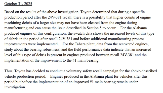

One thing is not clear to me but maybe someone here can help clear up. Were all engines built after 04/10/24 built with both the new cleaning process and the more robust bearing? Could there still be engines, such as mine build 04/18/24 built with the new cleaning process but not the new bearing? I read somewhere that the new bearings were not in the build process until 05/2024
I'm not sure we know this for sure - only Toyota would confidently this information.
Toyota (in typical Kaizen fashion) is still continuously tweaking their production processes and "monitoring the outcomes", meaning we and Toyota won't know exactly what production date fixed the issue until we see warranty rates a few years from now.
