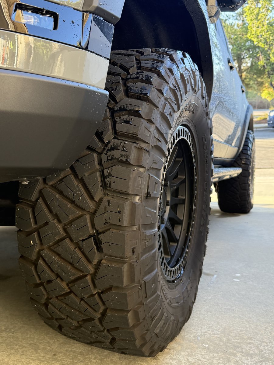

This is mine with 17x8.5 with +25 offset but with 35” tires

2.5” lift. Went with the Westcott Preload Collar. Removed the steel safety bracket on the backside of the front fender and a little trimming on the front side of the fender. Hardly noticeable.
