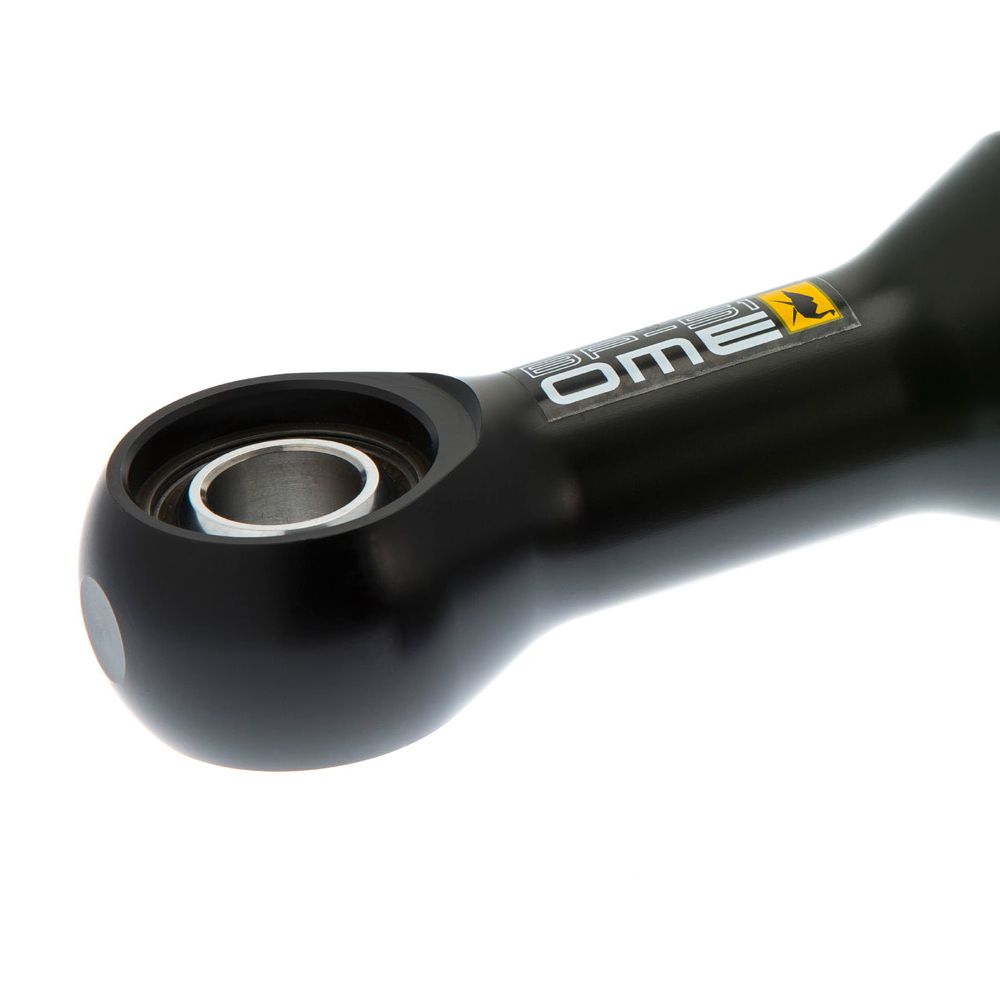

ARB/OME BP-51
It never actually settles. those avs shock are weirdly tuned.
We completely agree with this statement. After discussing this with the Lexus engineers the takeaway was "this is what was required to achieve the 9000lb tow rating". As not every customer requires this need for their use case, this is where quality aftermarket suspension makes a ton of sense (does not include spring spacers or entry level low technology shocks). My opinion is an upgraded suspension with quality shock absorbers is one of the most rewarding improvements that can be made to the GX550 platform. The comfort and handling can be improved for both a driver that has zero plans of ever going off road or intends to spend half their time there.
