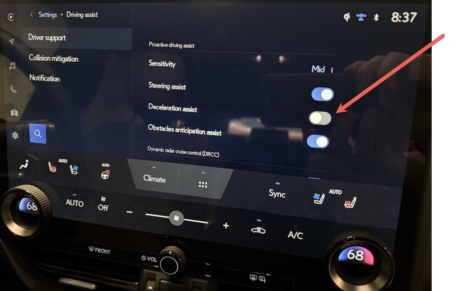

Does anyone know how to reduce the amount of engine braking when letting off the accelerator? When on the highway and you want to coast, it often aggressively engine brakes (activating rear lights). It makes me nervous, since it can be strong, but also looks like I am brake checking people behind me for no reason. Is there any tricks to changing the level?
I think that is one of the safety features that can be turned off. My wife commented on it today.

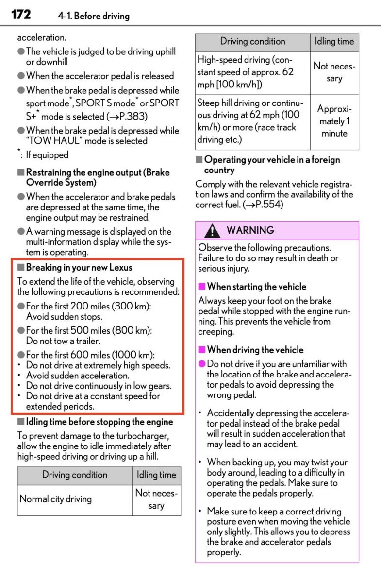

Manual is available online. Resources
The turbo cooling is very peculiar, I haven't seen this as a requirement since the 90s turbo cars where you had to idle the car after each drive. In fact my first turbo car a 2004 WRX manual stated you don't need to idle the car, as the coolant will cycle through even when the engine is off. It is conflicting as continuous drive of 62mph or more, which is literally every highway in the US, should be at fairly low rpm with a 10 speed, with zero turbo boost. Its not the same as turbos continuously spooling going up steep hill and race track driving.
This is a good indicator that V35A-FTS needs meticulous care
I noticed that in the owners manual too. While I have at least a 6 minute drive back to my house from high speed highways (well within the "drive for 1 minute at lower speeds" comment in the owner's manual) when returning from a trip, I have to keep in mind that lower speeds for at least a minute are necessary if I take the major highways to a destination. I have 147 miles on my GX that I picked up on Friday. I'm going to change the oil at 1,000 miles. Then I'm going to replace it every 6 months or 5k miles. I very rarely do 5k miles in 6 months - more like 2k to 3k every 6 months.
I also live about 5-7 minutes from a highway, which should be enough to "cool" but highway driving is not very strenuous, in fact its less strenuous then city driving. That section is very poorly written, you're okay with high speed driving of constant speed of 60mph, but continuous 60mph+ driving is where you need to 1 min idle otherwise you might damage your turbos :ROFLMAO:. My takeway is do the idle only if you have to immediately stop after race track session (which WHY in a GX??) or continuous WOT driving through twisty roads, going up 7 steep miles to Eisenhower tunnel on I-70, key point doing an immediate stop. No need to turbo cool after highway, especially when your destination a few minutes away.
It feels like a check the block thing, because of some possibility of oil cooking in the turbos if certain conditions are met. I wonder if the dealers are warning the new customers about this, I guarantee 99% of who buys GXs don't read the manual, cause oil cooking can be a big deal.
Easy fix is having an actual temp gauge, and telling "if it reads above XXX degrees, drive slow or idle the engine until it falls below XXXF before shutting off". If it was a big deal they would do that instead deciphering their word garbage.
Reactions: JPE
Agreed, ultimately it's not the MPH, it's the RPM and boost that heat up the turbo. I picked up my GX this past Friday and can tell you that my dealer made absolutely no mention of that section of the owner's manual. I might turn on the boost gauge display in my dash to see what kind of boost it's running during normal and aggressive operations.
Yes as you drive along just keep an eye on the gauge to get a good sense of when the turbos are in full boost vs barely coming out of vacuum (0 PSI). You'll notice a pattern during city driving, accelerating from light to light, highway cruise with cruise control vs your foot. All my past turbo vehicle flat highway driving would always be 0 or barely above 0 PSI to maintain speed. Going up a hill on a highway, especially a long hill, yes they were at full boost cooking (no pun intended)
These are smaller than normal turbos compared to sibling engine in the Tundra so maybe why they caution of oil cooking, these thing get red hot faster than normal? Who knows. I'd be interested to see if the new Tundra or Sequoia manual mentions it.
